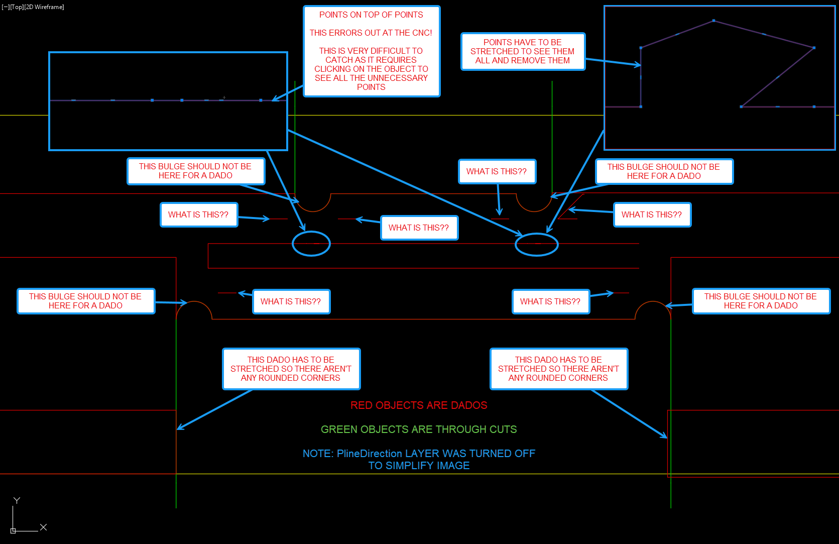

BUT they have to be BETTER than what they are presently. Recent analyzations have been a complete nightmare, especially when it comes to generating viable machining operations that won't error out on the CNCs.
The image below is an example of a work order I am currently trying to get out to the shop. I've had to draw every part in 2D to fix all the issues. This takes an extreme amount of time - and that's if I'm lucky enough to find them all!

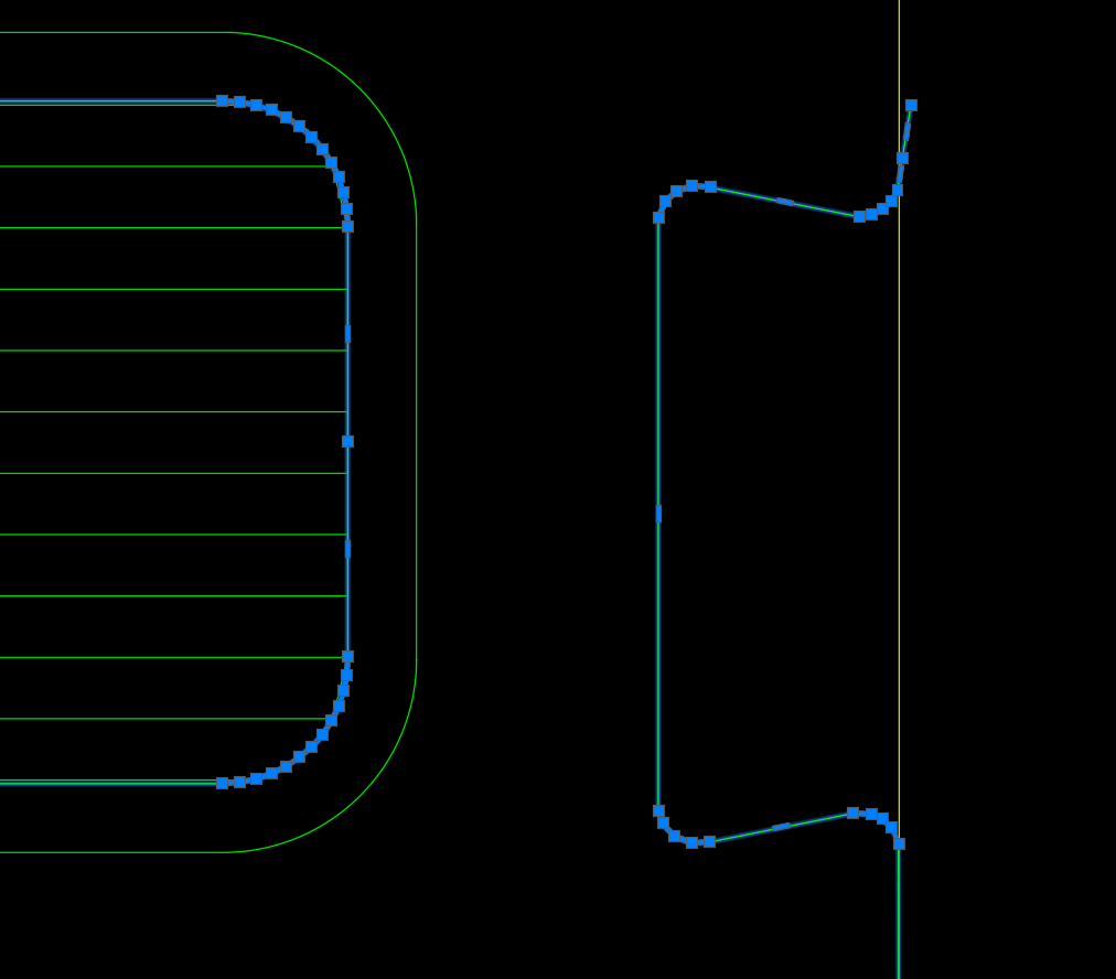

Another MAJOR issue is when 'faceted' polylines are created in lieu of a bulge. Those faceted polylines become a major issue at the CNC (they don't like little, tiny segments) and they take FOREVER to fix. I've literally spent DAYS removing points and filleting the geometry - you can't just fillet because there are too many segments in between, this is an AutoCAD limitation. So, everything must be done manually...
Another suggestion regarding the analyzation would be to change all the through cuts to be face 6 if non-through-cut machining exists on one face. Obviously, if non-through-cuts exist on both faces I'm going to end up with face 5 and face 6 machining. But in the case of the image above, I had to change all the through cuts to be face 6 so I don't end up with two programs to run.
