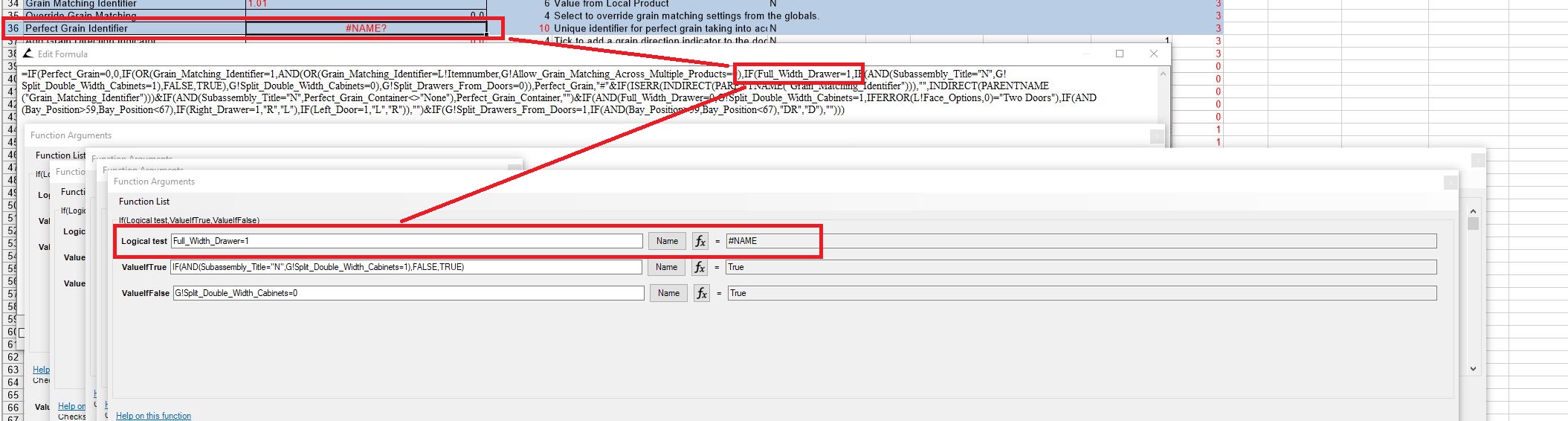

I am having an issue with graining with the solid wood door subassembly. This works fine with Slab doors. I am using a NON modified subassembly, this is a template level version. I am on library 26.0327 so the newest one.
There is a prompt for Full_Width_Drawer deep into the perfect grain identifier cell throwing a name error. This name and prompt exists in the MV Door sub. but not solid wood door therefore, it is not grain matching panels.
I am glad I caught this in the composite because I truly don't trust this program anymore when it comes to graining. I hope for some weird reason this is something on my library and an easy fix? I guess I can add the prompt and copy it over from the MV Door but this is slowing me down trying to cut some parts for a job.
