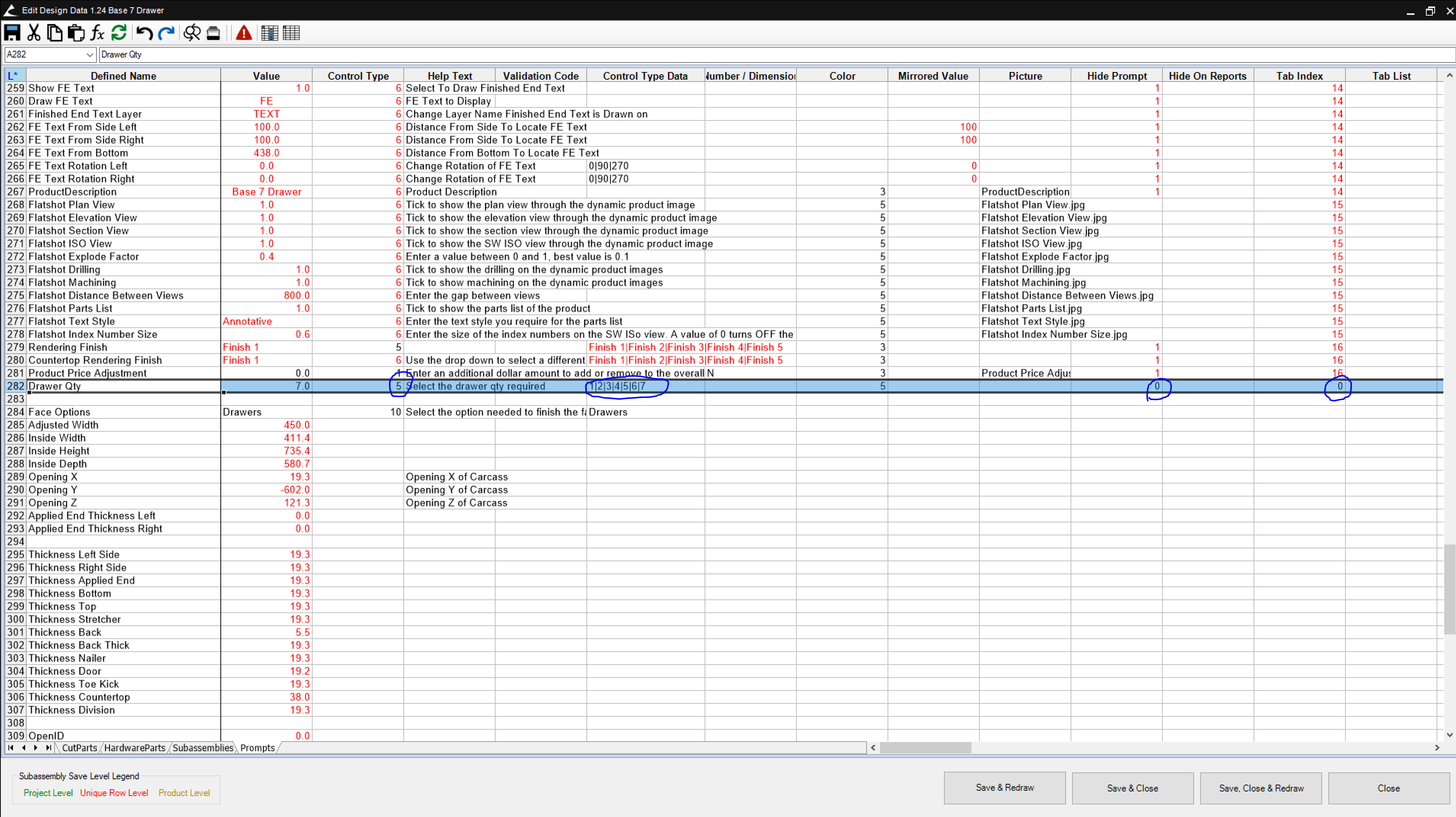

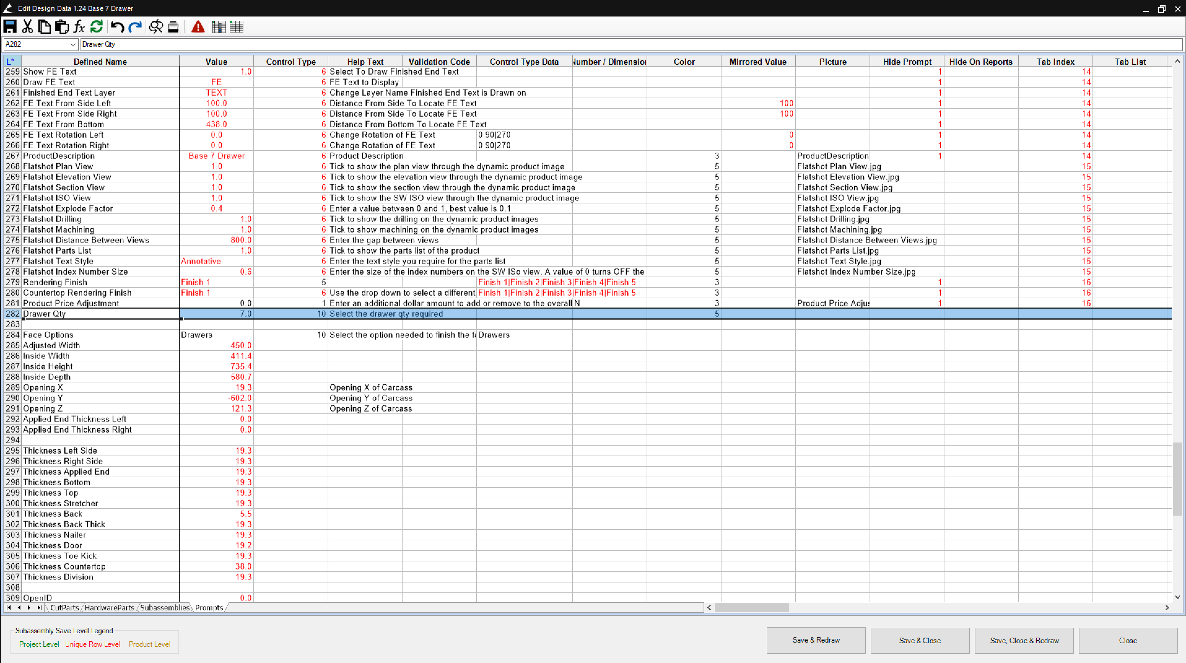

First we need to go into Edit Design Data of the cabinet, go to the "Prompts" tab, and find the Drawer_Qty prompt. We need to make this prompt visible on the main screen. To do that, the whole row for that prompt must NOT be below the first blank row in the spreadsheet, as shown below.
We must move it up to be above the first space. To do this carefully, first click on the blank row number to highlight the blank row. Then right click, and select "Insert". In the Pop Up Box the comes up, make sure that "Shift Down" is selected and then hit "OK". Now there should be two Blank rows, one on top of the other. Now select the entire row of the "Drawer_Qty" prompt and right click, and select "Cut". Now Select the top most blank row so the whole thing is heightlighted, and right click, "Paste".  Now Just select the blank row that used to have "Drawer_Qty" in it and delete it, ensuring that "Shift Up" is selected.
If you don't follow these instructions exactly you may have issues with the defined name not moving with the prompt name.
It should look something like this now:
Now, we make it visible to the main screen by making sure that the cell in that row under the "Hide Prompt" column is either blank, or 0. Also make sure that "Tab Index" Cell is set to the "Main" by entering either a 0, or this formula:
=MATCH("Main",N:N,FALSE)-1
You could put the "Drawer_Qty" prompt on any tab you like by swapping out the "Main" part of the formula and putting in a different tab name.
You must also change the Control Type cell value to 5, then it will be a drop down selection. In the Control Type Data cell, paste this:
1|2|3|4|5|6|7
This will be the options in your drop down list. Component Drawer Subassembly only goes up to 7 drawers, so do not go over this.
It should all look like this now:

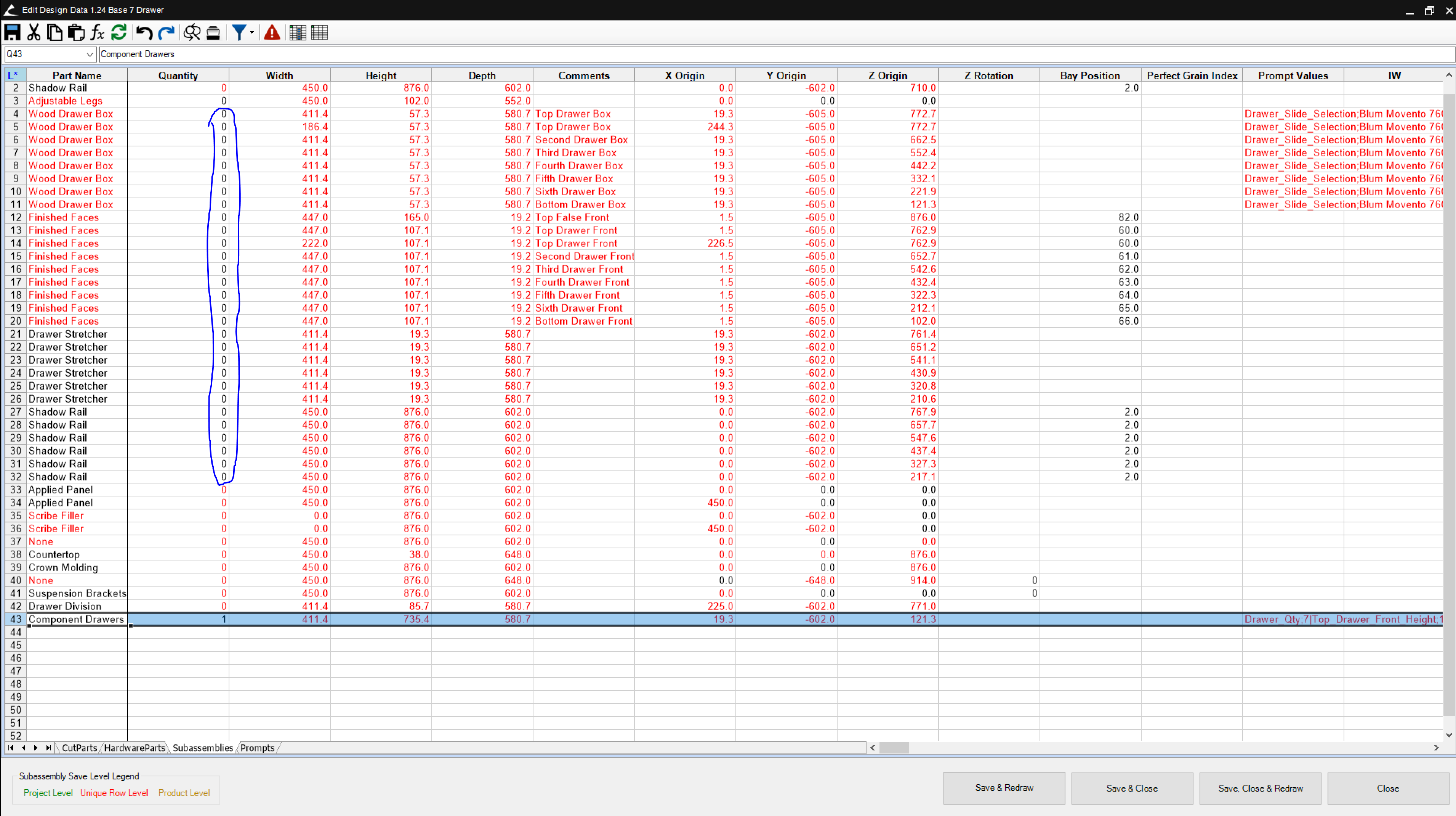

Now go to the Subassemblies tab in Edit design data. At the bottom of the list of existing subassemblies, add a Component Drawers subassembly as shown below. We also must formula drive many of the cells in that row. Copy and Paste the formulas below:
Quantity Cell: 1   (no formula needed here)
Width Cell: =Inside_Width
Height Cell: =Inside_Height
Depth Cell: =Inside_Depth
X Origin Cell: =Opening_X
Y Origin Cell: =Opening_Y
Z Origin Cell: =Opening_Z
Prompt Values Cell:
="Drawer_Qty;"&Drawer_Qty&"|Top_Drawer_Front_Height;"&Top_Drawer_Front_Height&"|Second_Drawer_Front_Height;"&Second_Drawer_Front_Height&"|Third_Drawer_Front_Height;"&Third_Drawer_Front_Height&"|Fourth_Drawer_Front_Height;"&Fourth_Drawer_Front_Height&"|Fifth_Drawer_Front_Height;"&Fifth_Drawer_Front_Height&"|Sixth_Drawer_Front_Height;"&Sixth_Drawer_Front_Height&"|Bottom_Drawer_Front_Height;"&IF(Drawer_Qty=2,Second_Drawer_Front_Height,IF(Drawer_Qty=3,Third_Drawer_Front_Height,IF(Drawer_Qty=4,Fourth_Drawer_Front_Height,IF(Drawer_Qty=5,Fifth_Drawer_Front_Height,IF(Drawer_Qty=6,Sixth_Drawer_Front_Height,Bottom_Drawer_Front_Height)))))
Also you must turn all existing drawer box, finished face subassemblies, Drawer Stretchers, and Shadow Rail Subassemblies off, or Delete them entirely. These things are now controlled by the Component Drawer Subassembly.
Your subassemblies tab should look something like this:

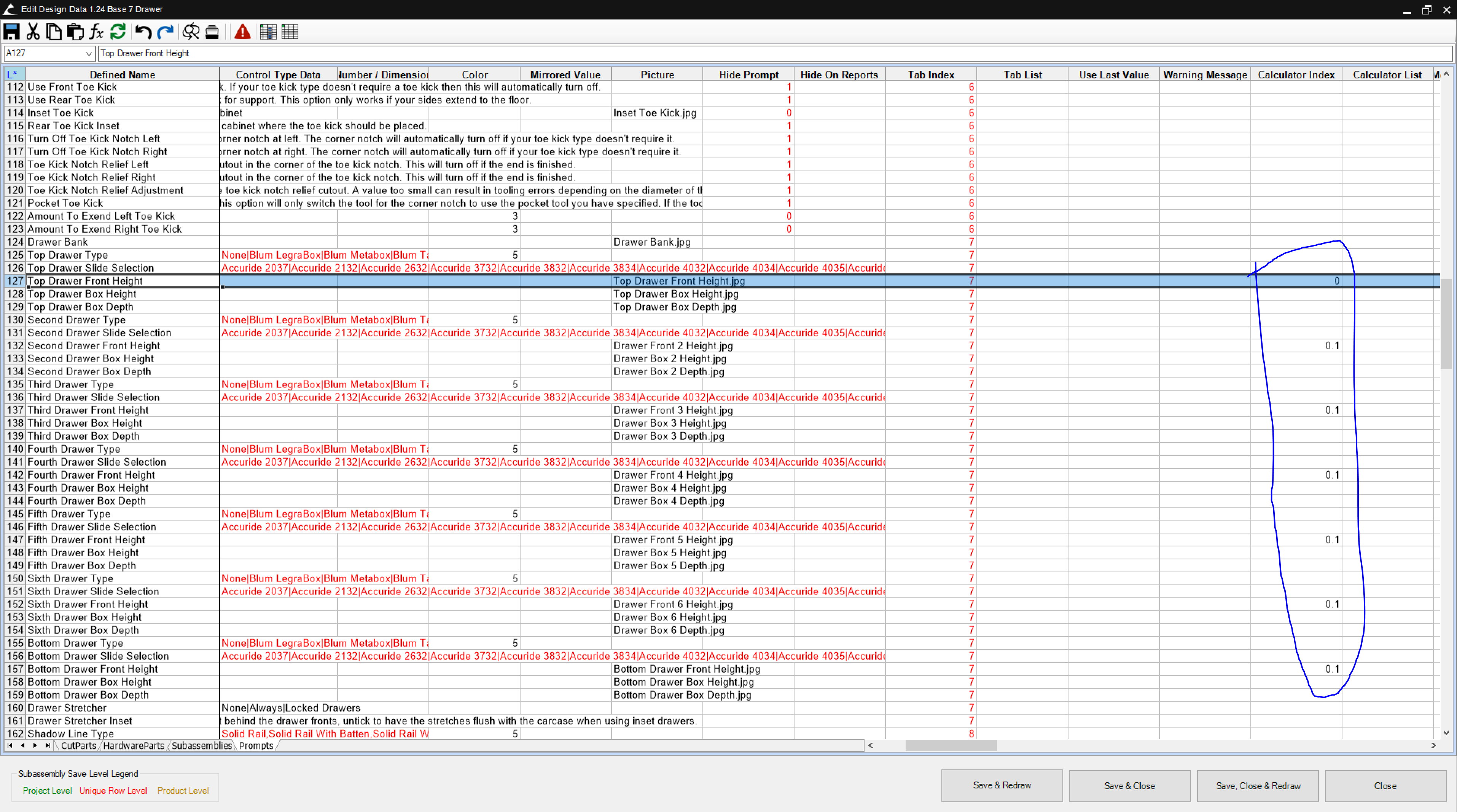

Now we go back to the prompts tab and find the Top_Drawer_Front_Height prompt. Put this formula in its value: =G!Default_Top_Drawer_Front_Height
Now scroll to the right a little bit on the spread sheet to find the column that says "Calculator Index" and in the Top_Drawer_Front_Height row, make it 0.
Make the Second_Drawer_Front_Height through Bottom_Drawer_Front_Height "Calculator Index" values 0.1, as shown below.

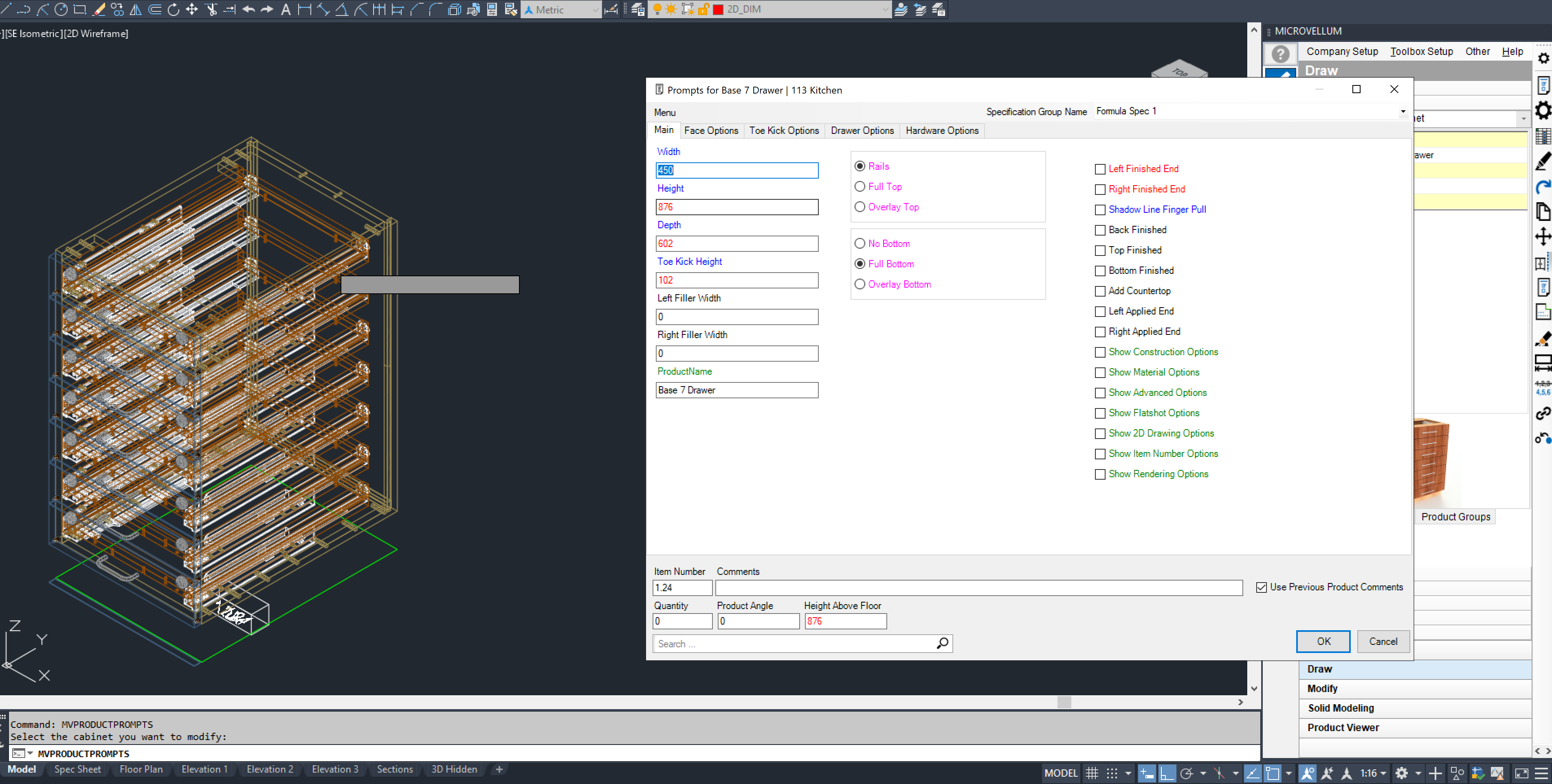

Now draw a fresh version of your new cabinet and test thoroughly, changing drawer quantities, using the drawer calculator, etc.
