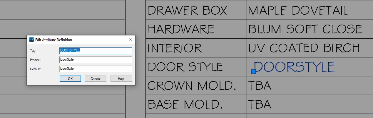

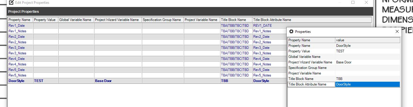

Struggling to make UDPP work with attributes in title blocks, please advise!

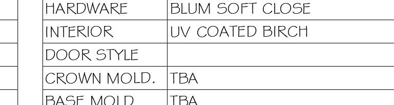

The issue I am having is the User Defined Project Properties data not "talking" with attributes I make inside a block. It keeps showing up blank and I cannot figure it out for the life of me. I am doing a test now to understand but eventually would like several text lines to show what is selected from our project wizard. I follow the directions in the KB articles and feel I am have set it up right but there is no information on how to actually set the attribute in CAD. I am updating the title block from the Microvellum tab.. Am I missing something?
