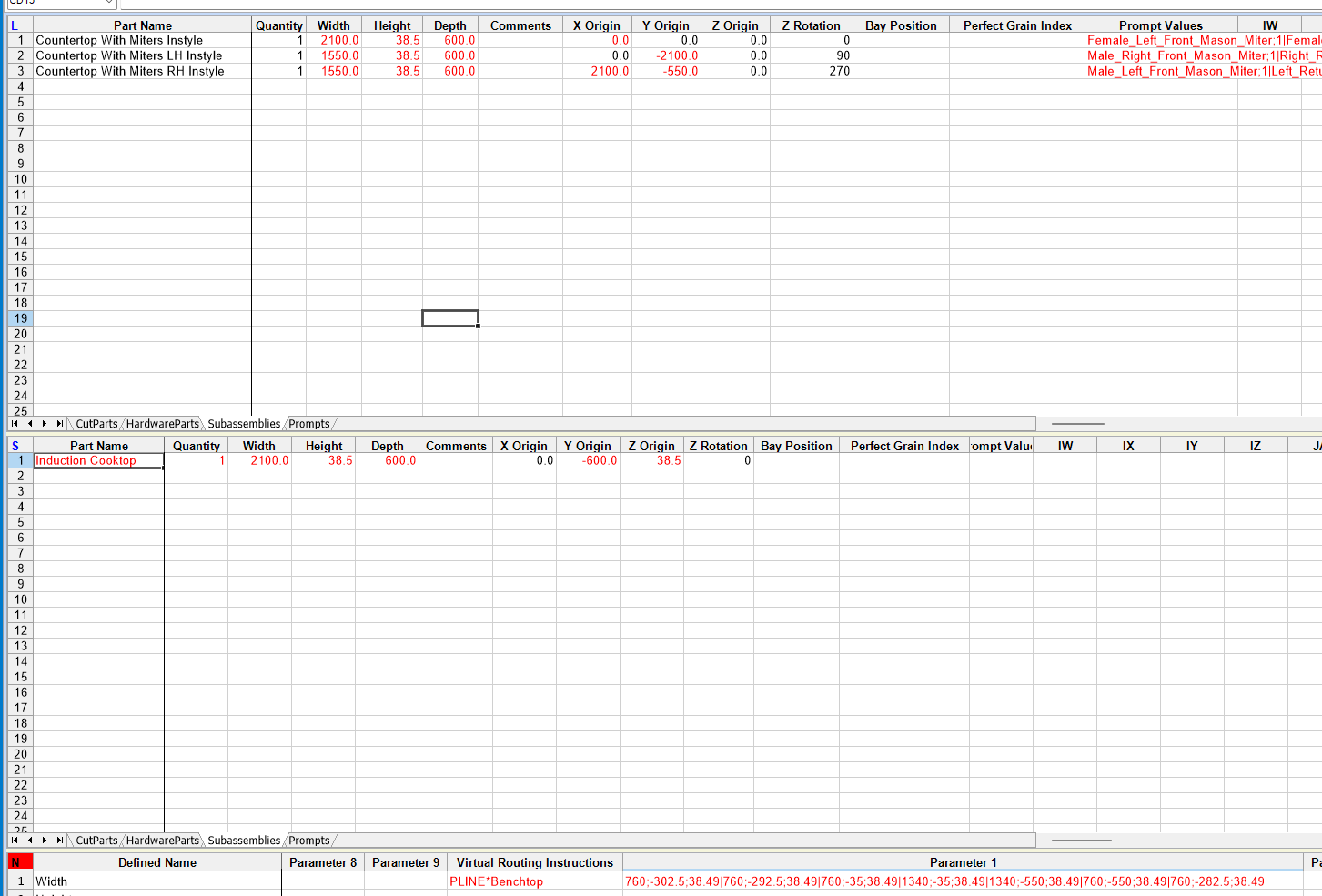

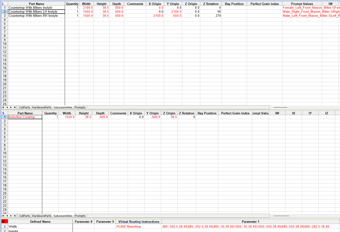

Hoping someone can shed some light with this one.
Product: Countertop U Shape (Modified)
Subassemblies: Countertop With Mitres & (Custom Name)

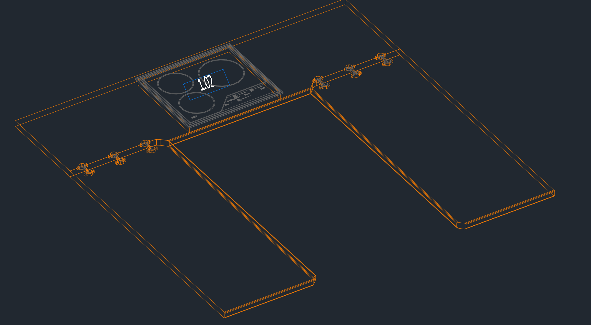

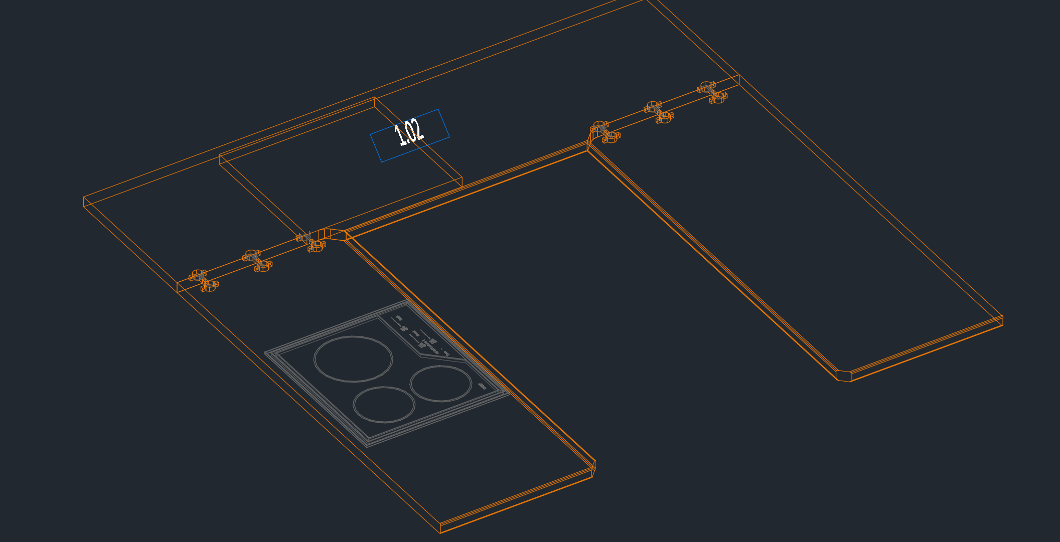

I'm looking to have nested subs (sink, cooktops) inserted into benchtops and automatically have the cut out. The virtual route work fine with the back benchtop however when added to the subassembly LH or RH return tops the nested virtual route places the cutout on the back benchtop.
The VR instruction is to PLINE*Benchtops. I tried changing the LH & RH subassembly names to PLINE*Benchtop LH & PLINE*Benchtop RH and changed the nested VR to match the same but it's doesn't work.
Anyone know how the VR can be specific to work with each subassembly / nested subassembly?
