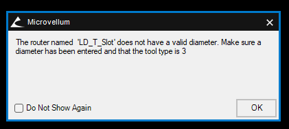

I have a question about the T slot tool file for Lockdowels. I am still working in the 50_7 component library for now and we are wanting to have the option to use lockdowels on our cabinets. I have set up the invisible fasteners in the construction method and entered a cabinet into my drawing. I get the following message for each machining process:

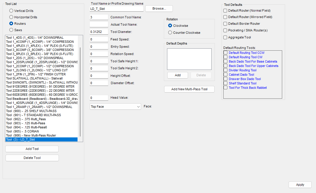

I have setup a tool file with a new tool as follows:
Should I have setup a Multipass tool or do I have something incorrect with the LD_T_Slot tool? Any help setting up the Tool file correctly would be greatly appreciated.
