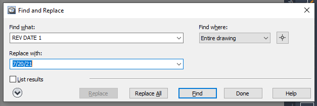

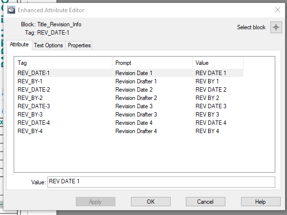

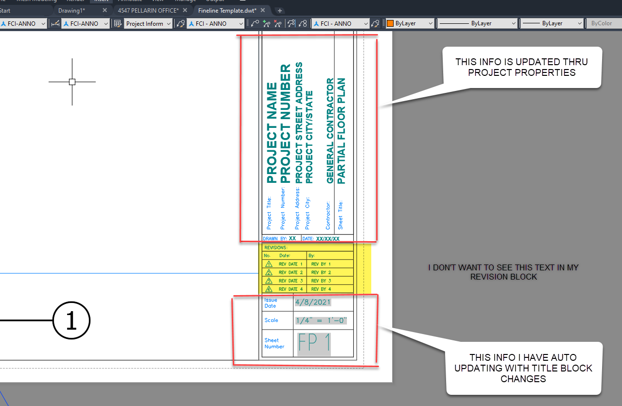

Looking for help. Forgive me for my naiveness but I just not that Acad Savvy. I'm trying to figure out a way that all this Revision info is not visible on my drawings, but able to add a Rev Date/By as needed quickly to all of the drawings.
Our current method is Find & Replace, which is easy, but I don't want to see all the Revision Info on the drawings. Any insight to other methods would be appreciated.
