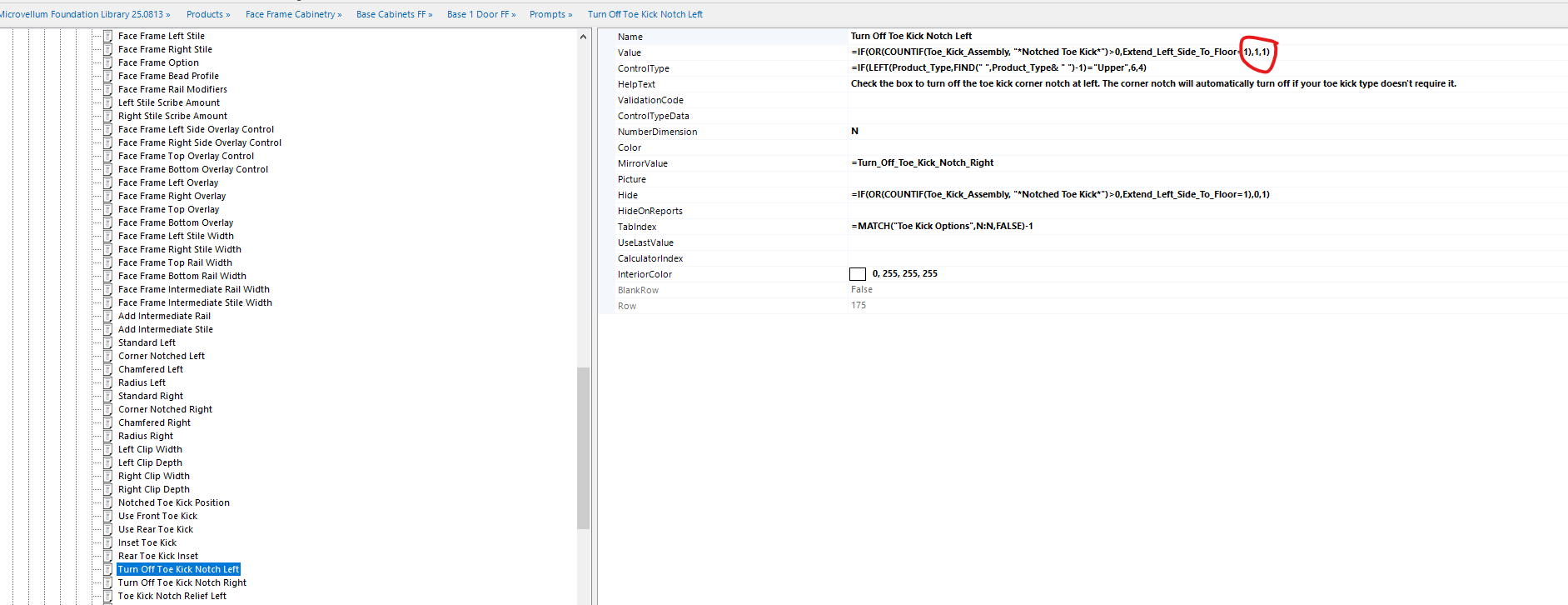

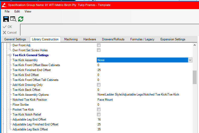

Toe Kick notch doesn't turn off
Since the forum is very active at the moment with support staff i have taken to posting all my problems here as i'm getting better results. Case i created almost a year ago Still isn't fixed when the problem was introduced. Case number: CAS-55822-W7T8V4. Change the 0 to a 1 in the default formula and this solves my issues as turning off the the global for a toe kick or toe kick notch does not work.
