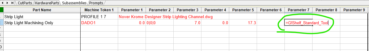

It seems the Under Panel product now uses the "Undermount Strip Lighting Insert" sub-assembly (which  is great!) However..

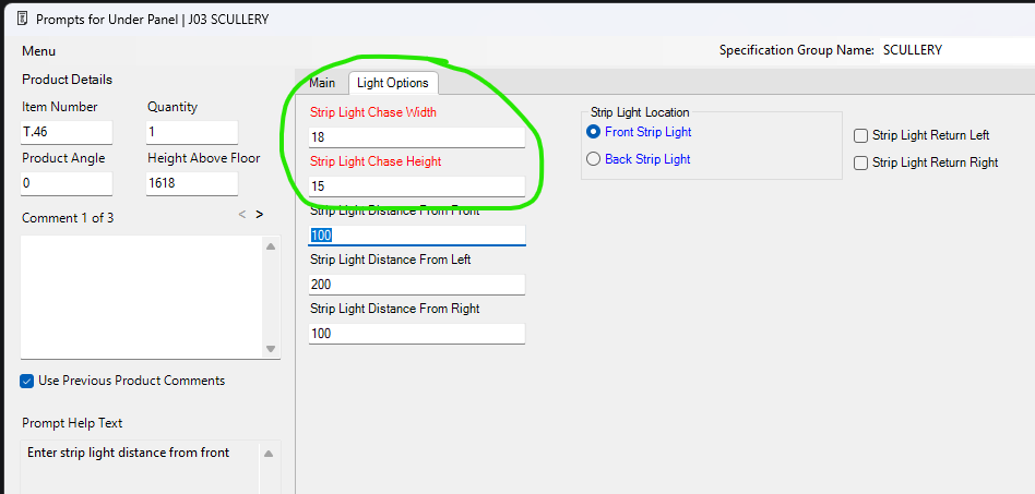

We've just found out the hard way that the Prompts "L! Strip Light Chase Width" and "L! Strip Light Chase Height" do absolutely nothing now. Which is very misleading. Should those 2 prompts be removed to avoid confusion?

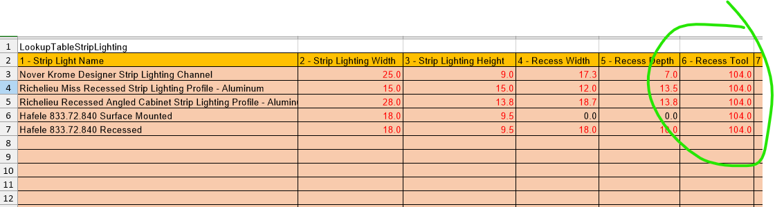

Also the routing for the strip light is using the wrong tool. It should be using the "Recess Tool" from the lookup table but it actually using the G!Shelf_Standard_Tool
