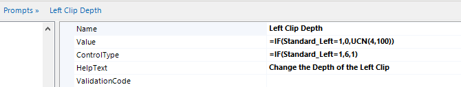

Update the Clip Depth for frame to be a depth option as well
I update my library after every update, for the left and right clip depth on face frame, to match the control type for the width, because in my experience it does not work out the box, if i want a 45mm round it make its 45mm wide but does not match it in the depth, so any applied ends are 55mm away from the now rounded ends.
