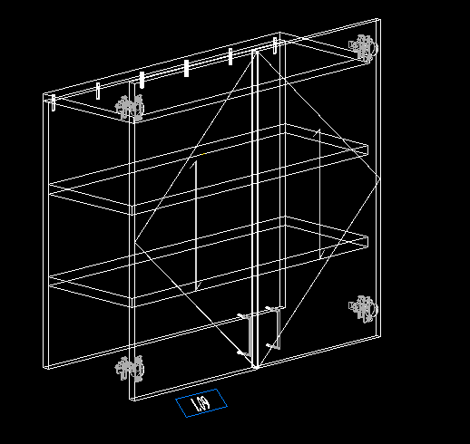

I am in the process of upgrading to the 23.0210 library and while testing, I am having problems with my wall cabinets not drawing properly.  You can see in the attached screenshot that the sides are not drawing along with a few other issues.

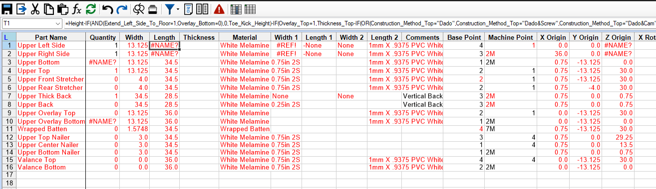

Looking at the design data, I am getting quite a few #NAME? errors.
The length column of the upper sides is the start of it so perhaps some help there.  This is the formula that is in that box:
=Height-IF(AND(Extend_Left_Side_To_Floor=1,Overlay_Bottom=0),0,Toe_Kick_Height)-IF(Overlay_Top=1,Thickness_Top-IF(OR(Construction_Method_Top="Dado",Construction_Method_Top="Dado&Screw",Construction_Method_Top="Dado&Cam"),G!Dado_Depth,0),0)-IF(Overlay_Bottom=1,Thickness_Bottom-IF(OR(Construction_Method_Bottom="Dado",Construction_Method_Bottom="Dado&Screw",Construction_Method_Bottom="Dado&Cam"),G!Dado_Depth,0),0)-IF(Left_Side_Full_Height=0,Bottom_Z_Offset,0)-IF(Left_Side_Full_Height=0,Top_Z_Offset,0).
