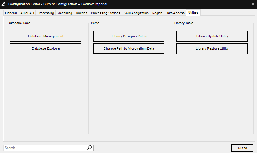

The Path to the Microvellum Data folder can be changed as necessary from the Microvellum Options page.
Step 1: Open Toolbox Setup > Options > Utilities > Change Path to Microvellum Data.

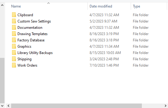

Step 2: Navigate to and select the desired folder containing your Microvellum data for the configuration in which you're working. The basic data folder layout is available below.
