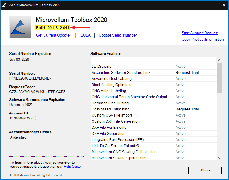

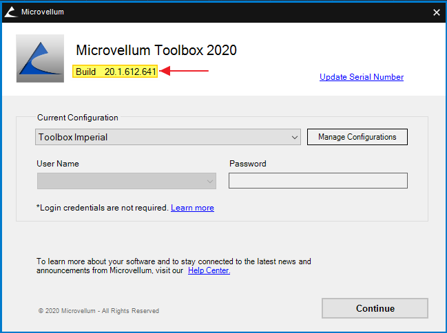

  10. Enter the software build number you are currently running. The build number is located near the upper left corner of the Login Screen (Figure 6) or the Help/About window (Figure 7).

    Fig. 6 – Login Screen Build Number
    Fig. 7 – Help/About Build Number

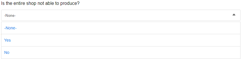

  14. Select the radio button if you are experiencing a production shut down.
  15. Fig. 10 – Production Shut Down
    A production shut down is defined as an inability to produce products or operate machinery from any workstation.
    1. Upon selecting that production is shut down, select whether or not the entire shop is shut down or just a portion of the production.
    2. Fig. 11 – Establish Extent of Shut Down

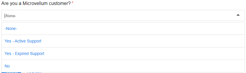

  16. Select whether or not you are a customer with active support, a customer with expired support, or not a current customer at all.
  17. Fig. 12 – Establish Customer Status
    1. If “Yes – Active Support” – Select your country and state/province.
    2. If “Yes – Expired Support” – Select your country and state/province.
    3. If “No” – Select whether you have a trial, would like a trial, or do not have a trial. Select country and state/province.

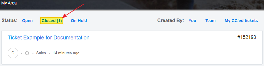

To reopen a ticket, reply to it via email. If you can’t find the email, you can go to “My Area” here in the Knowledge Network (located in the menu bar above), find your closed ticket and reply to it there. Click on the “Closed” link near the top of the page to find your solved/closed tickets.
Fig. 14 – Closed Tickets in “My Area”
After you reply to the closed ticket, it will be reopened and automatically assigned to the tech that was helping you last. If your “My Area” section does not show the ticket as “Open,” you may need to wait for 30-seconds or so for the system to refresh.
