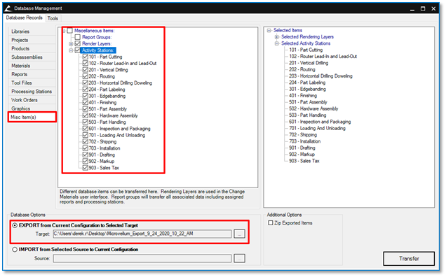

The Misc Item(s) tab of the Database Management Utility allows for the transfer of three separate database items:
  1. Report Groups – Transfers all associated data, including selected report groups, their associated report templates, and associated report dataset definitions.
  2. Render Layers – Transfers all associated data to the Layers table. These layers originate from the Change Materials user interface.
  3. Activity Stations – Transfers all associated data, including selected activity stations and their categories.
Select the Misc Item(s) tab > select the Misc Item(s) to be exported > accept the file to be exported to or browse for a different location.
Fig. 01 – Database Management Utilities – Export Misc Item(s)

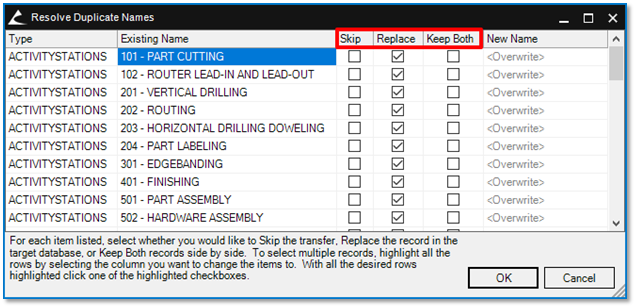

Resolving Duplicates
When the file being exported to is empty, or lacking a MicrovellumFactory.sdf database, a database is automatically created with the exported data inside. When the file being exported to already has a MicrovellumFactory.sdf database, and this database features duplicate information, the Resolve Duplicate Names window appears. When there is no duplicate information, the data being exported is appended to the database.
  4. Fig. 04 – New Name
