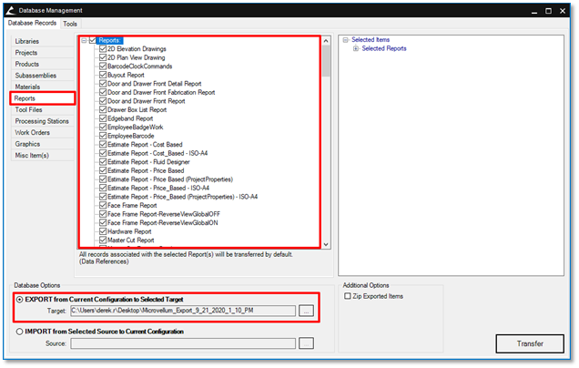

This simplified article provides a brief tutorial for exporting Reports using the Database Management Utility.
All records associated with the selected Report(s) (Data References) are transferred by default.
Select the Reports tab > select the Report(s) to be exported > accept the file to be exported to or browse for a different location.
Fig. 01 – Database Management Utilities – Export Reports

Once everything has been selected for export, and any desired additional options included select Transfer.
With the Database Management utility, multiple items from multiple categories can be exported at once.

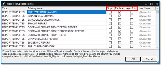

Resolving Duplicates
When the file being exported to is empty, or lacking a MicrovellumFactory.sdf database, a database is automatically created with the exported data inside. When the file being exported to already has a MicrovellumFactory.sdf database, and this database features duplicate information, the Resolve Duplicate Names window appears. When there is no duplicate information, the data being exported is appended to the database.
There are three options to resolve duplicate names:
- Skip – Does not change the existing item, and an additional item is not added. The item is ignored.
- Replace – Replaces the item in the target location that has the duplicate name.
- Keep Both – Appends to the target location. A new name must be given to the item.
