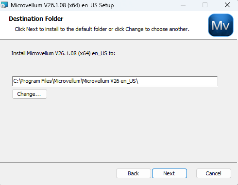

    1. All instructions that apply to installing BSB 2025 apply equally to 2026 with one exception: BSB 2026 uses a different file path and separate application folder.
      1. This should not require any action on the user end to install, but it is relevant to note if intending to run BSB 2025 and 2026 on the same device.
  5. Once the instructions in the installation document are completed, the software will be installed.
Microvellum BSB 2026 is a separate application from Microvellum BSB 2025, and will install in its own file location, using its own file path and directory. BSB is capable of being installed and run on the same device as Microvellum BSB 2025, with all data being interoperable, including one's license. This new application does not modify or overwrite anything from BSB 2025. The two software applications are capable of being installed and run side-by-side on the same device.

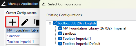

As previously stated, Microvellum BSB 2026 does not alter any existing projects, library data, or system configurations. As such, it is fully interoperable with anything created in BSB 2025, requiring no data migration whatsoever. After installing the software, simply:
  1. Launch BSB 2026.
  2. When prompted, add a new configuration.
  3. Select your current Microvellum configuration.
  4. Immediately continue where you left off.
Installing and running BSB 2026 should thus cause little to no disruptions in any existing Microvellum workflows.

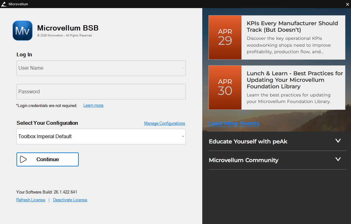

  10. How do I know what version of BSB I am running?
    1. When you launch Microvellum BSB, the “Powered by BricsCAD” splash screen appears briefly and displays the version. For BSB 2025, you will see version 25.2.08, which reflects the bundled BricsCAD Pro version. For BSB 2026, you will see version 26.1.08. Additionally, the BSB 2025 icon includes the letters “TB,” while the BSB 2026 icon includes “MV.”
