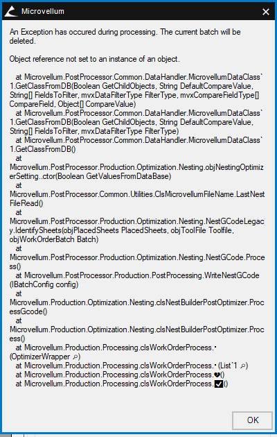

File Name Fix
  1. An issue was occurring when processing work orders with the Create Sequential File Names setting enabled. When the setting was enabled, a work order being processed would sometimes experience an error, causing the batch to be deleted. This issue has been resolved, and this error should no longer occur when creating files with sequential names.

  2. An issue was reportedly occurring wherein certain work orders would experience an error during processing. This issue was determined to be related to database coding, and as such, has been resolved. Work orders should no longer elicit this error.
