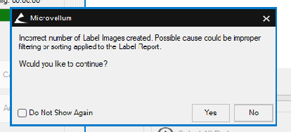

Label Image Fix
Fig. 1: An error noting an incorrect number of Label Images.
  1. An issue was reported wherein creating new G-code from an existing work order that was edited using nesting tools would prompt an error. Users specifically would receive an error stating that there was an incorrect number of label images. This issue has been resolved- the error should no longer appear in new work orders. However, it should be noted that while this issue has been resolved for new work orders, existing work orders with this issue may still have this problem occur. It is thus recommended to recreate and re-process any work orders that have prompted this issue.

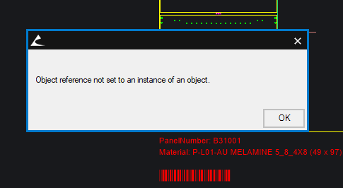

Fig. 2: The object reference error upon updating a part.
  1. When changing the processing station during nest editing of a composite, it is expected that parts will update to reflect the changes in processing station rules. However, some users instead experienced an object reference error, preventing the part from being updated properly. This issue has been resolved- this error should no longer occur when attempting to update a part and changing processing stations should result in the expected changes in the composite.

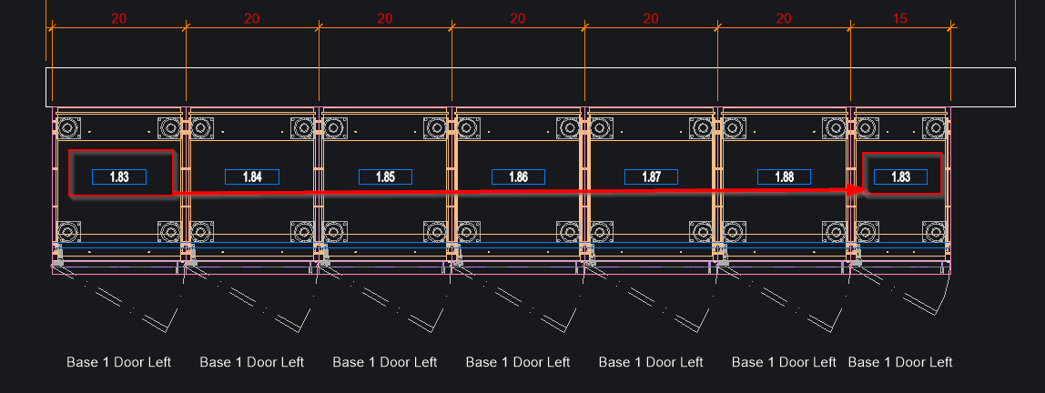

  2. Some users reported an issue with filling walls with products. After filling a wall with products, it was sometimes the case that modifying the values of the products would result in one of the products changing its item number to match the first product placed. This issue has been resolved. Additionally, a slight change has been applied to ensure that when working with multiple products, the Product Prompts UI will automatically save and close, as opposed to allowing one to use the “Save” option, to prevent issues with multiple products being drawn or modified.
Fig. 3: The item numbers of the first and last product erroneously matching.
