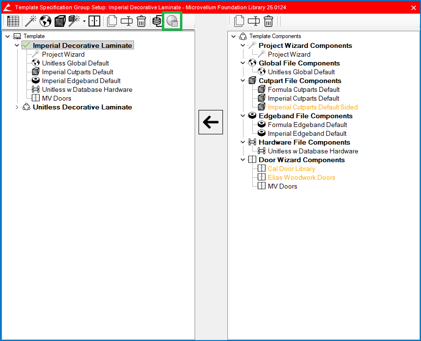

Assign Render Material
  1. A new option has been added to the Library Specification Groups interface: Assign Render Material. This new interface displays the Microvellum material texture library alongside one’s material file, allowing users to easily and seamlessly assign different material textures to different parts of specific materials in their file. For more information on this feature, visit the following article.

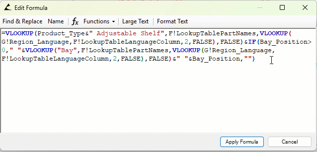

Colored Formula Parentheses
  1. An improvement has been made to the formula editor in Edit Design Data: formula parentheses will now display different colors to indicate which parts of the formula interact.

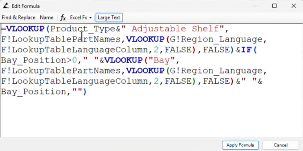

Format Formula Text
  1. Another improvement has been applied to the formula editor in Edit Design Data. A “Format Text” button has been added to the interface to allow users to change the formatting of their formula text between the base, existing style and programming style text. This button only changes the formatting and style of the text, it does not apply any other alterations or modifications to it.

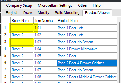

Room Name Fix
  1. An issue was reported with the “Draw All Products in Category” option in the Draw tab. After the command was used to draw products in a room, some users found that the room name would fail to appear in the Product Viewer. This issue has been resolved, room names should now appear correctly.

Formula Editor Fixes
Numerous reported issues centered on the formula editor have been resolved:
  1. The Apply Formula button within the Edit Material interface would sometimes disappear during editing.
  2. The formulas applied would sometimes not be saved correctly, instead disappearing after exiting the Edit Formula interface.
  3.  Some users found that certain cells within workbooks were unable to be edited normally, only being able to change using the Formula Editor upon being clicked, even if the edits involved were not related to formulas.
  4. Redundant and unnecessary options and buttons within the formula editor have been removed.
  5. An issue was reported when editing functions- editing a function should ordinarily maintain the existing formula and change only the specific parts of the formula that were modified. Some users reported that after modifying a function, however, the formula would simply duplicate within the cell, breaking it.

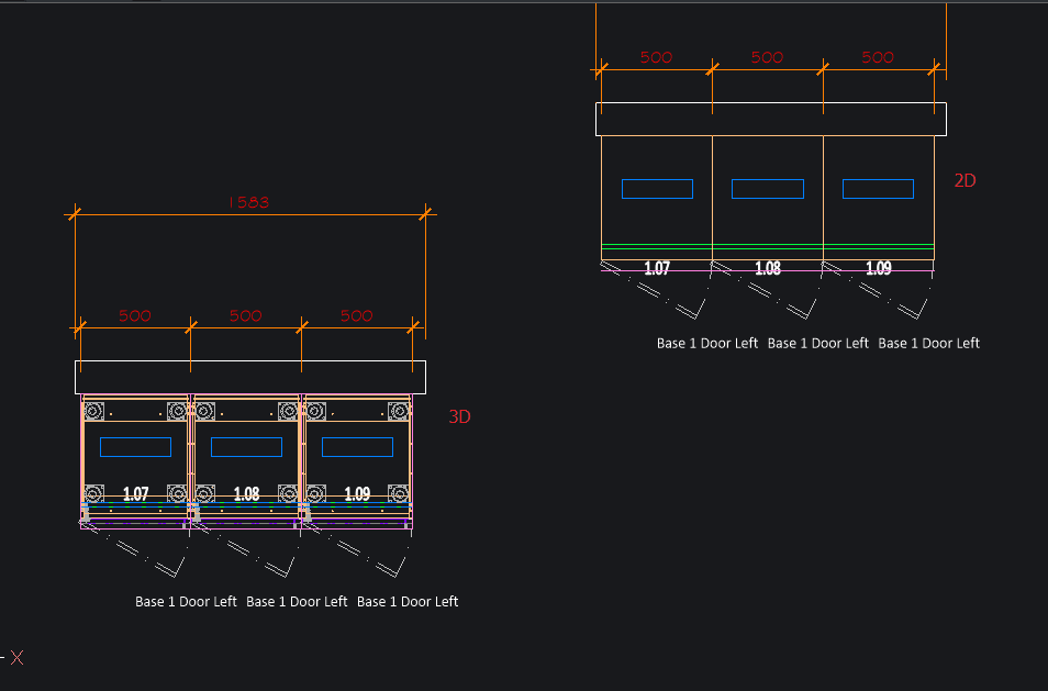

Item Number Fix
  1. An issue was reported regarding item numbers. When a product is drawn, then its scale is changed afterwards, it is expected that the item numbers will scale appropriately with their block’s size. Some users found this was not the case, with the item numbers remaining the same size regardless of the product or block scale, leading to item numbers appearing on the incorrect face or being difficult to read within the product drawings. This issue has been resolved, and numbers should now scale correctly with their blocks.
