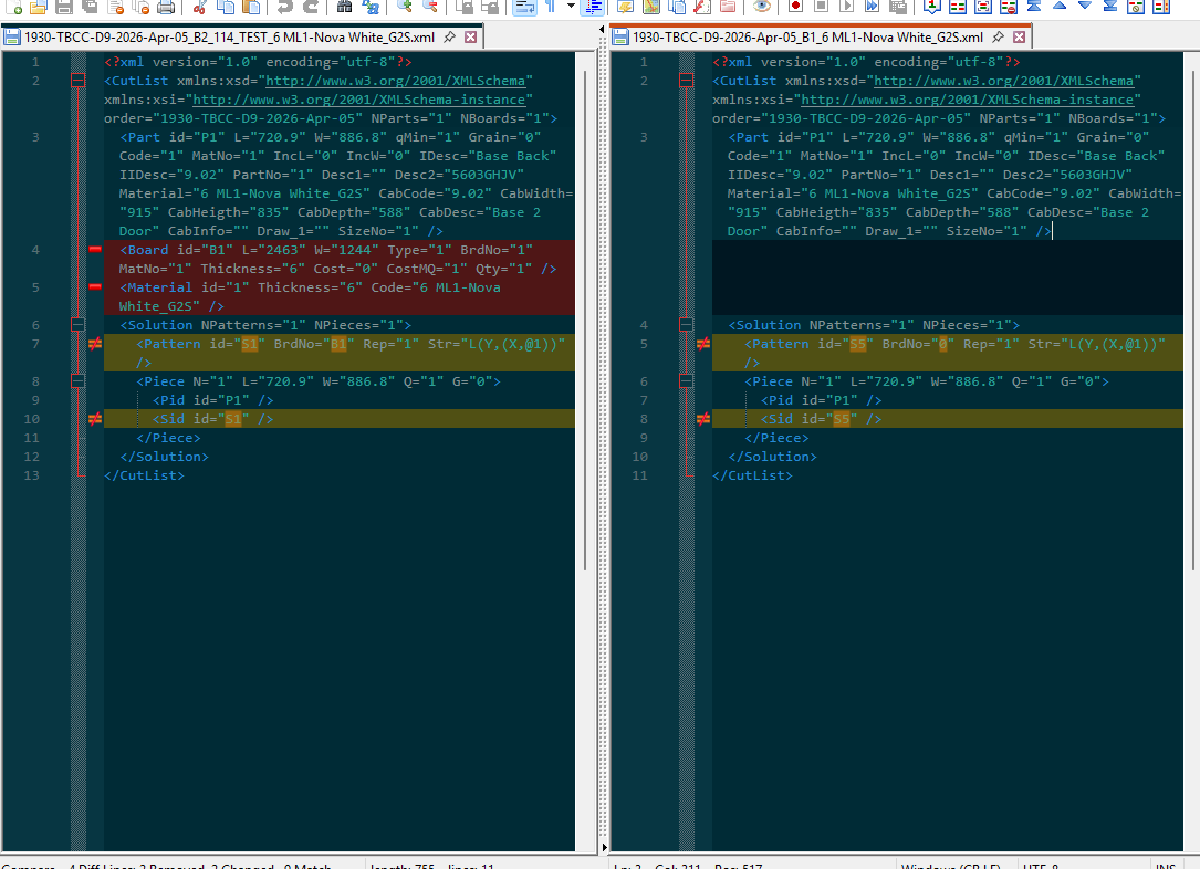

Saw XML Fix
  1. An issue was reported with the output of specific sawing G-code. Namely, when processing a product in a more recent software build, users found that specific lines of code would be dropped from the G-code without explanation. This issue has been resolved. There should no longer be any missing lines of code.

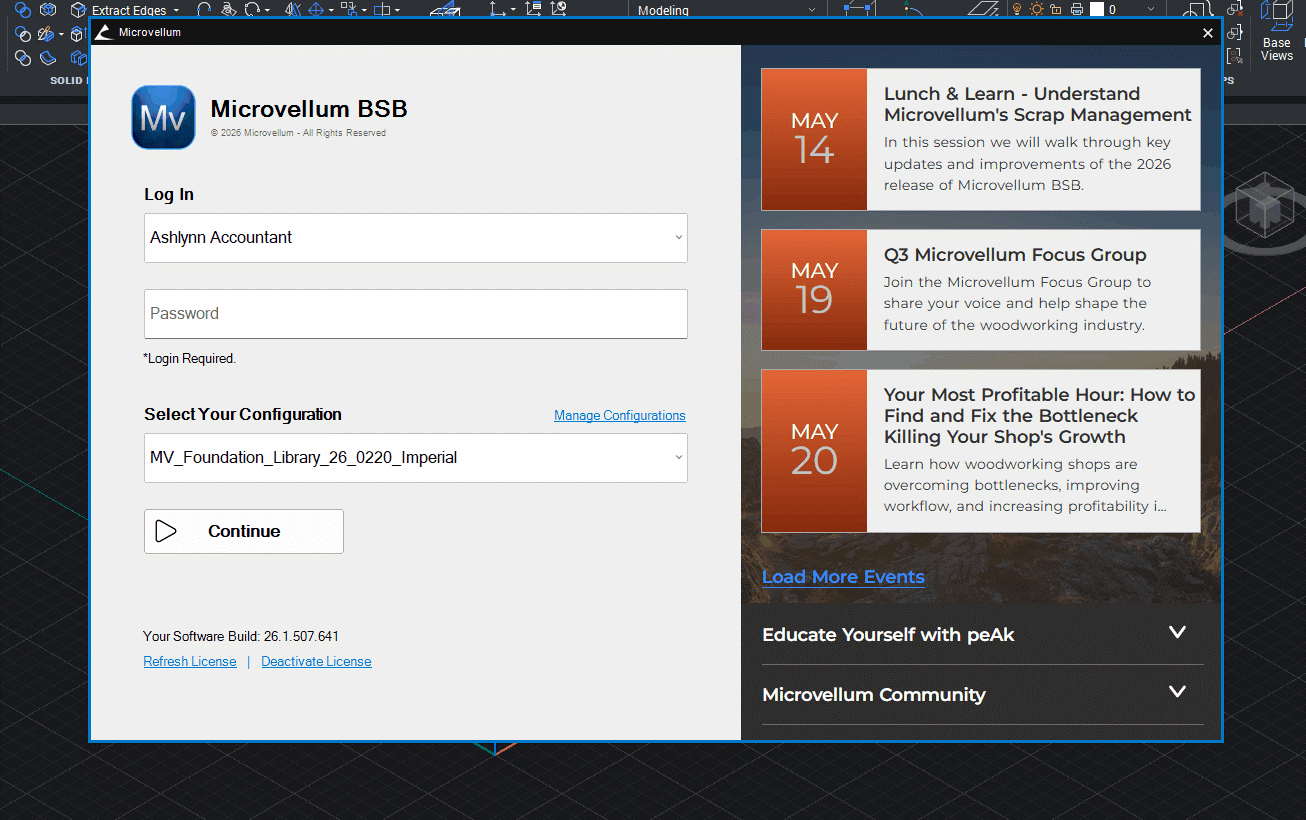

Configuration Fixes
A pair of issues were reportedly occurring when users attempted to switch between configurations.
  1. Users who switched between library configurations found that attempting to login using their credentials after the switch would cause issues; the logged in user would not remain logged in and be locked out, even as an admin, the user name would sometimes revert to the first on the list, and there would sometimes be an error when entering one’s password. All of these issues have been resolved. There should no longer be problems with logins, regardless of configuration.
  1. It is expected that the password field of the login screen will be cleared of any existing text after switching between users. This was reported to not be the case for some users, with the password text remaining in place even after changing user. This issue has been resolved. When switching users, the password text should now reset.
