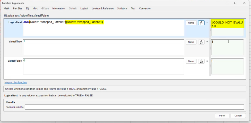

Function Editor Fix
  1. Users reported an issue that would sometimes occur when working in the Formula Editor: when editing a formula using the 'Fx' button, clicking Insert would sometimes fail to update the formula, instead causing an error wherein users were told that the formula could not be evaluated, often inserting part of the function twice. This issue has now been resolved- users should now be able to drill into a function, edit it, and insert it back with the full call replaced cleanly and no duplication. If the text highlighted isn't a recognized function, a clear message, and the dialog still opens so you can build one over your selection.
