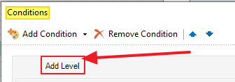

Sometimes a condition will require more than one comparison operation. A circumstance like this is when a Multi-Part Condition is necessary.
To add a second condition, select Add Level in the Conditions window.
Fig. 1 – Add Level

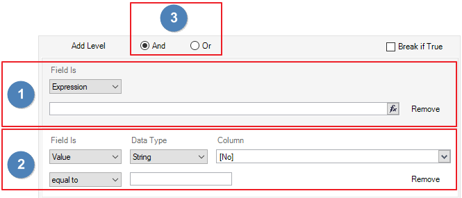

Fig. 2 – Multi-Part Condition
  1. This is the first condition.
  2. This is the second condition.
  3. Use these radio buttons to establish the type of logical addition. If BOTH conditions must apply for the overall multi-part condition to evaluate as true, select And. If either of the conditions can be true without the other having to be, select Or.
