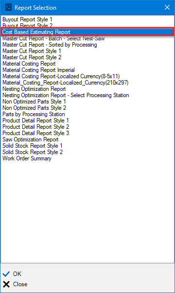

  1. Create a work order from either the drawing or from the Product List. There is no need to process the work order in the Processing Center before viewing the costing data, but on the other hand, you may still view the reports if you do process the work order in the Processing Center.
  2. Open the work order in the Processing Center and click “General > Reports > Print Reports” and double-click the "Cost Based Estimating Report."
Fig. 1 - Report List Including the Cost Based Estimating Report
