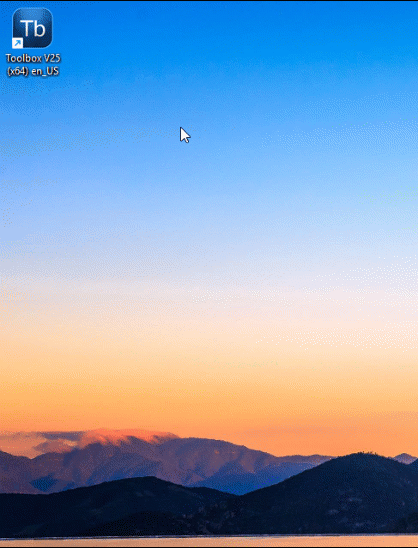

There is a quick fix for scaling issues like this demonstrated in Figure 02.
Fig. 02 - Scaling for HD Monitors Fix
  1. Right-click Microvellum software's icon.
  2. Select Properties.
  3. Select the Compatibility tab.
  4. Select Change High DPI Settings.
  5. Check Override High DPI Scaling Behavior.
  6. Select the "Scaling Performed by" drop down > Select System (Enhanced)
  7. Select OK > Select OK for changes to be saved.
