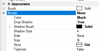

The border property can be found in the Appearance section of the Object Inspector.
Fig. 1 – Object Inspector > Appearance > Border

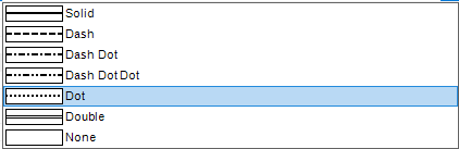

Style
The Border.Style property controls the style of the border. There are seven styles available:
Fig. 3 – Border Styles

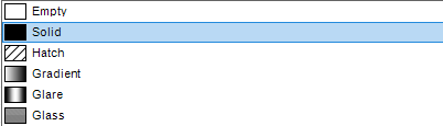

Shadow Styles
There are five shadow styles available:
Fig. 6 – Shadow Styles

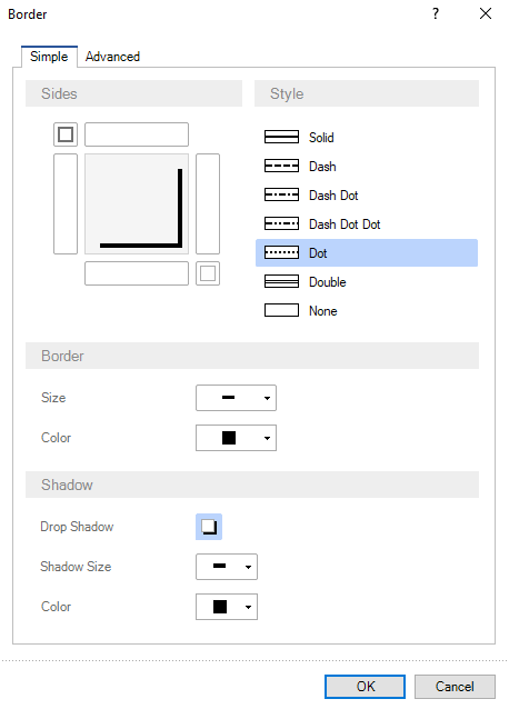

Access
As stated earlier, the border properties can be accessed directly through the Object Inspector. Select the ellipsis next to the Border property to open the Border window for easier manipulation.
Fig. 8 – Border Window > Simple Tab
