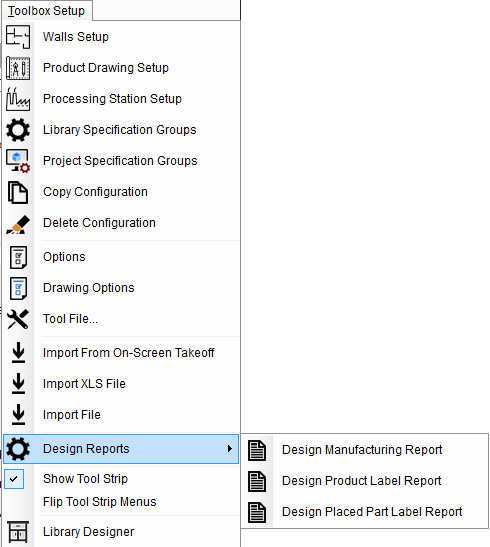

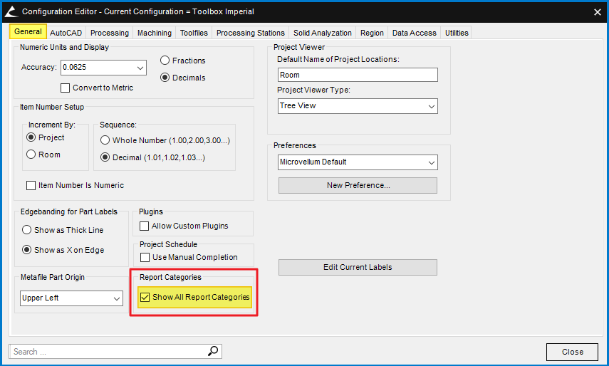

To address this issue, but still preserve access to all the reports from a single workstation running only Toolbox, the program has been modified to contain an option to view all report categories or only those that apply to Toolbox. Click “Toolbox Setup > Options > General.” Unchecking the box will cause Toolbox to display only the categories: manufacturing reports, product labels, and placed part labels.
Fig. 1
Fig. 2
Checking the box ON will cause Toolbox to display all the categories. This gives Toolbox Users access to modify all the reports without the use of Production.
