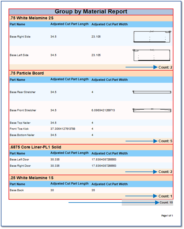

Figure 01 features an example of the report template for a report with groups set up. Notice, the same expression has been entered in both the Group Footer band and the standard Footer band. Figure 02 displays the difference the location of this expression makes in the final rendering of the report.
Fig. 02 – Group Footers in a Rendered Report
Notice that the Group Footer bands counted the Data Rows in the individual groups, and the standard Footer band counted every Data Row in the report.
