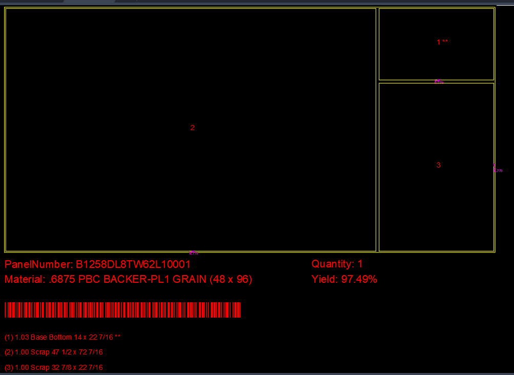

Nesting yield with scrap turned on

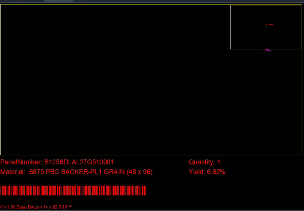

Nesting yield with scrap turned off
