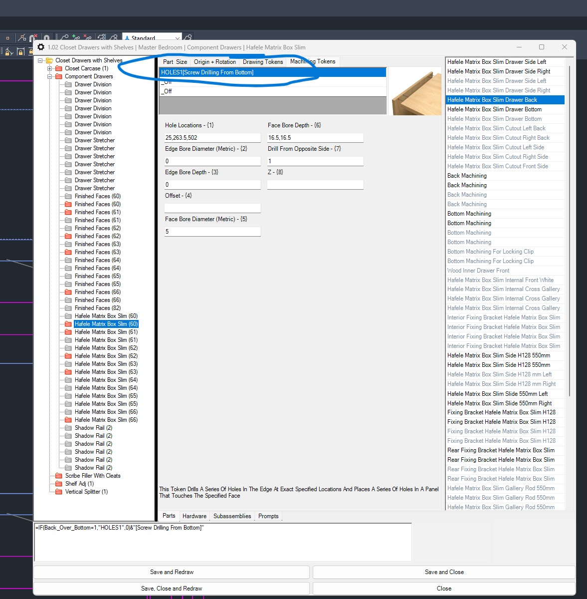

Hi,
Can this please be fixed up for future libraries:-
Drawer back hole locations
H89 =M2U(25,G!Accuracy)&"|"&M2U(25+32,G!Accuracy)
H128 =M2U(25,G!Accuracy)&"|"&M2U(25+32,G!Accuracy)&"|"&M2U(25+32+32,G!Accuracy)
H175 =M2U(19.5,G!Accuracy)&"|"&M2U(19.5+32,G!Accuracy)&"|"&M2U(19.5+32+60,G!Accuracy)
Front fixing bracket type - default 10mm dia. Nested sub prompt option is screw-on only (5mm dia).
Drawer back - remove Holes1 associative token as the drawer bottom is short from the back in depth. NL-10.
Drawer back - Move back 10mm in positive Y to NL depth. Holes1 above is redundant from this anyway.
Cheers
