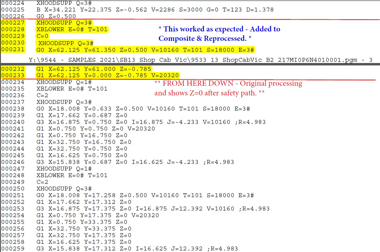

Has anyone had problems with the part perimeters not cutting? Since updating to build #21.1.519.641, my WO's processing G-code's for the perimeter passes as Z=0, two-paces!
I added from the Composite Nest, a Manual scrap cut-off and that cut with the same tool worked fine, all other perimeter's Z=0.
All other operations seem to work fine. Yes, found this while running at the machine.
I've attached a .pdf of the G-Code, look to the bottom of page 3 and below.
