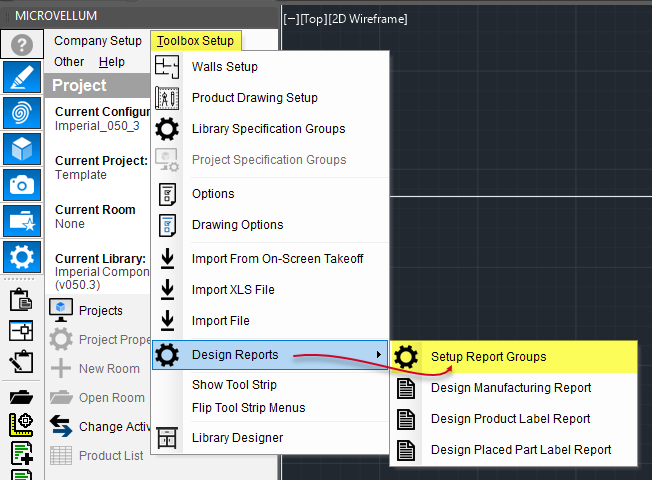

Create and edit your report groups from “Toolbox Setup > Design Reports > Setup Report Groups.”

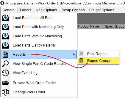

Manually print the reports in your report groups by setting the appropriate group option and then printing the group from “Processing Center > General > Reports > Report Groups.”

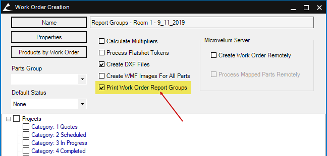

Set up your reports to execute after a work order is created by setting the appropriate group option and then creating a work order. The reports will be automatically rendered and either printed to the default Windows printer, or the export files will be created in the specified format at the location specified.

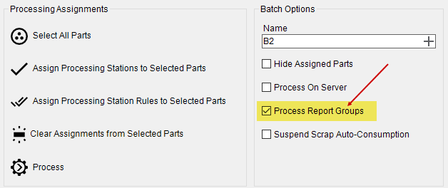

Set up your reports to execute after a batch is processed by setting the appropriate group option, checking the box Process Report Groups on the Processing Center screen, and then process the work order. The reports will be automatically rendered and either printed to the default Windows printer, or the export files will be created in the specified format at the location specified.
Fig. 1 – Report Groups Configuration Access

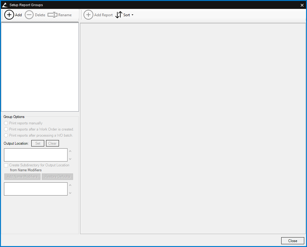

Fig. 3 – Report Groups Screen After Adding Groups but Before Adding Reports

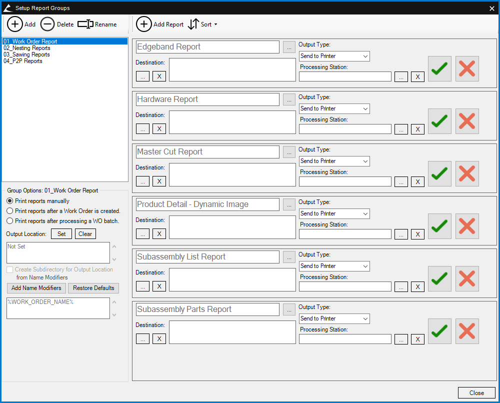

Fig. 4 – Report Groups Screen After Adding Groups and Reports
Fig. 5 – Work Order Screen Checkbox to Activate Automatic Report Group Printing for the Work Order
Fig. 6 – Processing Center Screen Checkbox to Activate Automatic Report Group Printing for the Batch
Fig. 7 – Processing Center Access to Print Report Groups
