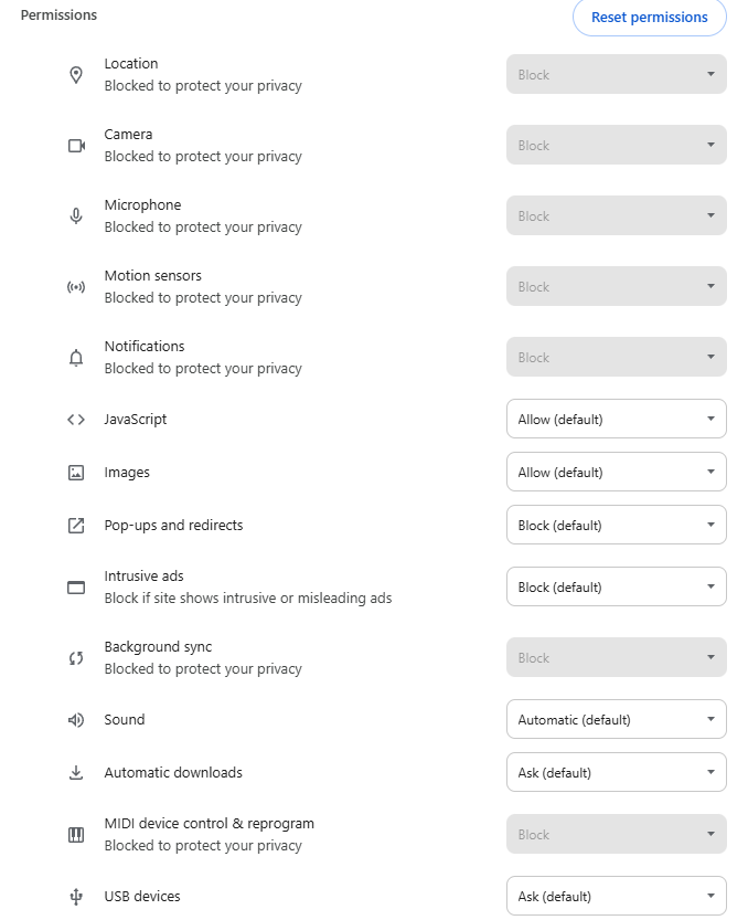

How to whitelist a website on Chrome?
Figure 1: Google Chrome's permissions page.
  1. Open the Chrome browser and find your account settings. This should be in the upper right corner of the browser interface, under your profile image, under "Google Services Settings".
  2. Open the Privacy and security section, then open Site Settings.
  3. Select "JavaScript" under the Content heading or select "View permissions and data stored across sites" (if you have visited the sites already).
  4. Find or add both websites above, check their permissions, and set them to the "Allow" option of JavaScript.
