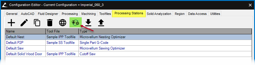

  1. Open Toolbox and click Toolbox Setup > Options > Processing Stations.
  2. Click the Activity Stations button. It is the button with the two small circles and opposing arced blue arrows. Since the Activity Stations are set up for each separate configuration, it doesn’t matter which Processing Station is selected.
Fig. 1 - Accessing the Activity Stations

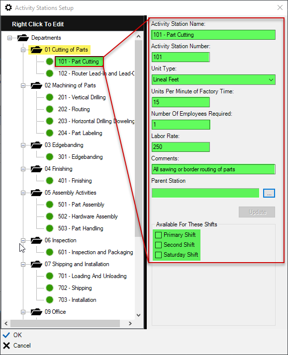

  1. In the section ’01 Cutting of Parts’, click the station named ‘101 – Part Cutting.’ The property descriptions are as follows, accompanied by the values found in the Cabinet Component Library v050.5.
    1. Activity Station Name: “101 – Part Cutting”
    2. Activity Station Number: 101 (use the default numbers for the stations as found in the Help Center article How to Use the Microvellum Project Costing Tools Figure 5 as the default activity station numbers are hard-coded strings in the costing reports.)
    3. Unit Type: Lineal Feet
    4. Units Per Minute of Factory Time: 15
    5. Number of Employees Required: 1
    6. Labor Rate: 250
    7. Comments: “All sawing or border routing of parts.”
    8. Parent Station: [Enter a parent station if the station you’re modifying is dependent on, or a secondary operation to another station. This property does not apply to the majority of Activity Stations.]
    9. Update button: [Click this button to save the properties of a single activity station before moving on to the properties for another station without having to close the interface.]
    10. Available for These Shifts:
      1. Primary Shift: (not checked)
      2. Second Shift: (not checked)
      3. Saturday Shift: (not checked)
  2. After setting the properties for the first station, click the button ‘Update’ and select the next station to edit from the list on the left.
  3. When all the station properties have been set, click OK.
Fig. 2 - Activity Station Properties
Once you have completed the steps above for all the activity stations in a configuration, you are ready to create work order data and view the Cost Based Esitmating Report.
