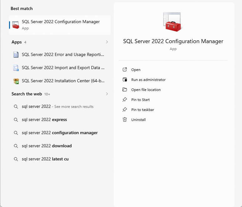

  1. Before using SQL Server Express with Microvellum, you must configure it to work in a network environment. To do this, start the “SQL Server 2022 Configuration Manager.” If using Windows 10, press the Windows key and begin entering “SQL Server 2022 Configuration Manager” in the search bar, as shown in the image below. When the desktop app is displayed, either click it or press the Enter key. Alternatively, press the Windows key and scroll down to the M section. Find and click “Microsoft SQL Server 2022 > SQL Server 2022 Configuration Manager.”

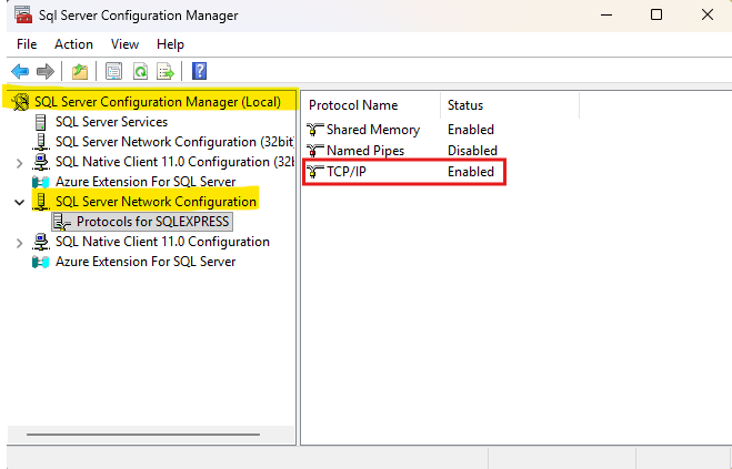

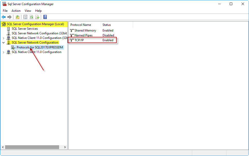

  2. In the SQL Server Configuration Manager dialog box, expand “SQL Server Network Configuration” in the left half of the window and click on “Protocols for <named instance you created in the first tutorial> - in this case, Protocols for SQLEXPRESS. Double click on TCP/IP on the right side of the screen and set the Enabled property to Yes. Click Apply and OK.

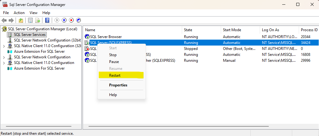

  1. You now need to activate the modification you made by restarting the SQL Server Service. In the same SQL Server Configuration Manager dialog box, expand “SQL Server Services” on the left, and right-click on “SQL Server(<your_instance_name>).” Click “Restart” and wait for the service to be restarted.

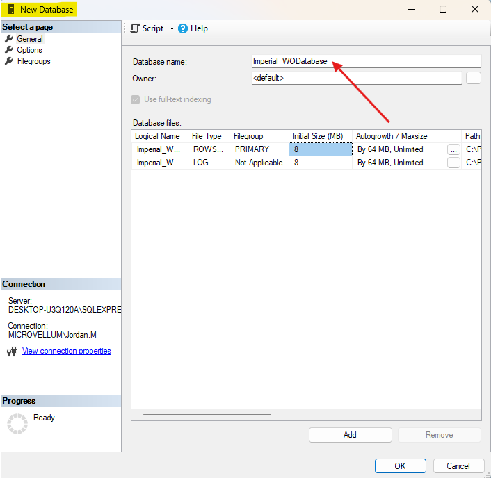

  9. When the Management Studio is open, right-click Databases, and click New Database.
  10. Give the new database a name in the New Database screen. In this example, the database has simply been named "Imperial Work Order Database". Microvellum recommends naming the database appropriately, such as including the library version or any specific details within the name. Click the OK button when finished.

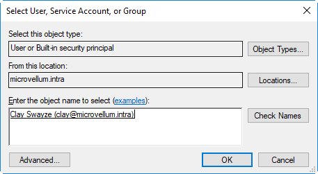

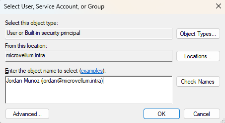

    5. To create a Windows-type user login, enter the login name and click the “Search…” button.
    6. In the Select User or Group window, click the “Locations…” button and select "Entire Directory" or your domain server name, and then click OK.
    7. Enter a username in the box under “Enter the object name to select” and click the button Check Names. This searches for that user on the network to have access to the SQL server data. Type in the available field the username or the person's name you are trying to add and select the "Check Names" button. Once it has underlined itself as in the figure below, click OK and OK a second time to create the login.

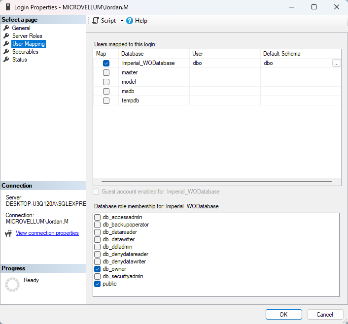

  2. The last step in configuring your new database is to map the Users to the databases that they will have permissions to use.
    1. Open a user login you have created and click on "User Mapping" in the left column. In an area named “Users mapped to this login,” select the database you are allowing the user to access and check the checkbox next to that database. Typically, it will be the database you just configured in this tutorial.
    2. Check the checkbox “db_owner” in the area named “Database role membership for:” and when finished, click OK.
