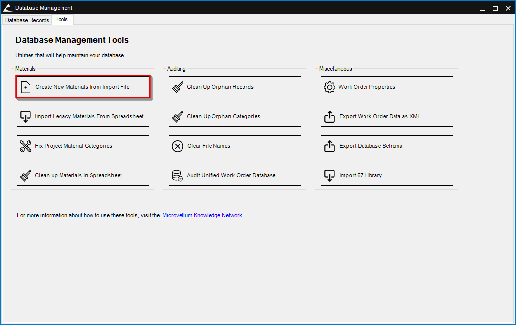

We've added a new “Create New Materials from Import File” command to the Database Management Tools tab.
This tool allows you to select an Excel file and create or modify database materials by import.  During the import, if a material name is found in the existing database materials it will modify the properties, if an existing material name is not found a new material will be created.  You will have the option to review the materials that will be created or edited before continuing.
If an existing sheet stock material is found and there are sheet sizes listed out for the material in the import file, existing materials in the database will be updated with the sheet sizes from the import file.  If no sheet sizes are listed, the sheets in the database will not be updated.
