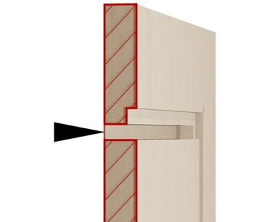

Below are samples of the various reveal and gap controls available.
Base Top Gap
Base Bottom Gap
Door Reveal Inset Door
Door Gap
Horizontal Door Gap
Door to Cabinet Gap
