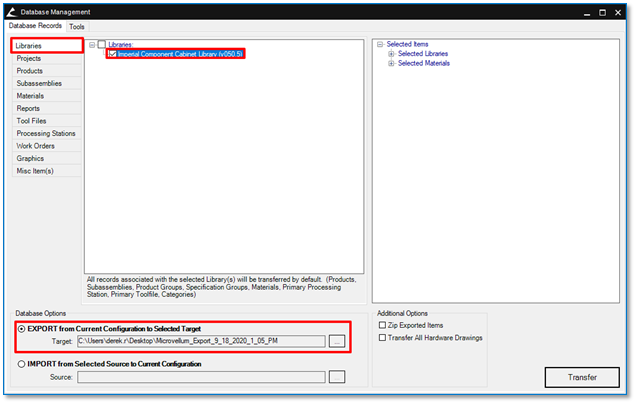

Select the Libraries tab > select the Library to be exported > accept the file to be exported to or browse for a different location.
Fig. 01 – Database Management Utilities – Export Library
When a library is selected for export, all of the Library’s materials are selected by default, as shown in the right-hand pane in Figure 01. These materials can be unselected in the Materials tab.

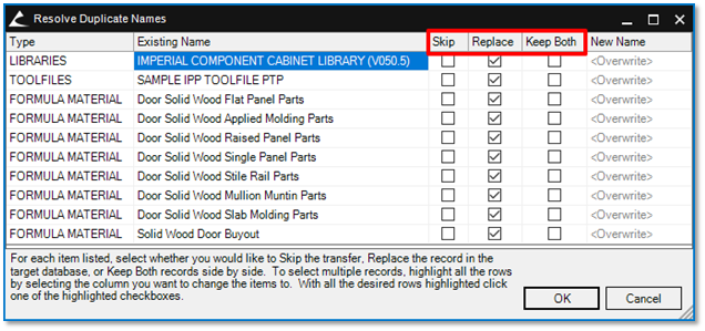

Resolving Duplicates
When the file being exported to is empty, or lacking a MicrovellumFactory.sdf database, a database is automatically created with the exported data inside. When the file being exported to already has a MicrovellumFactory.sdf database, and this database features duplicate information, the Resolve Duplicate Names window appears.   When there is no duplicate information, the data being exported is appended to the database.
  4. Fig. 04 – New Name
