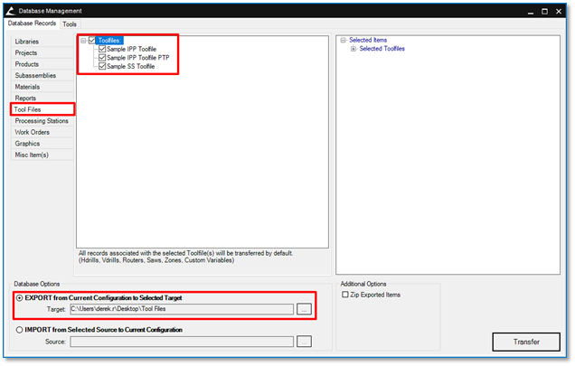

This simplified article provides a brief tutorial for exporting Tool Files using the Database Management Utility.
All records associated with the selected Tool Files(s) are transferred by default. These records include HDrills, VDrills, Routers, Saws, Zones, and Custom Variables.
Select the Tool Files tab > select the Tool File(s) to be exported > accept the file to be exported to or browse for a different location.
Fig. 01 – Database Management Utilities – Export Tool Files
Additional Options
When exporting Tool Files, the following Additional Options are available:
Fig. 02 – Additional Options when Exporting Tool Files
  1. Zip Exported Items – Check this box to create a compressed zip file named the same as the folder selected for the export files. The zip file contains the same files as the subfolders created in the folder designated for the export files and is located at the same level as the folder selected.
Once everything has been selected for export, and any desired additional options included, select Transfer.
With the Database Management Utility, multiple items from multiple categories can be exported at once.

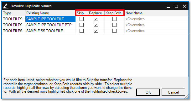

Resolving Duplicates
When the file being exported to is empty, or lacking a MicrovellumFactory.sdf database, a database is automatically created with the exported data inside. When the file being exported to already has a MicrovellumFactory.sdf database, and this database features duplicate information, the Resolve Duplicate Names window appears. When there is no duplicate information, the data being exported is appended to the database.
There are three options to resolve duplicate names:
  4. Fig. 04 – New Name
