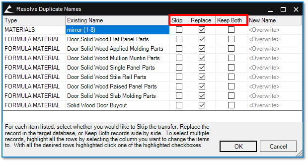

Resolving Duplicates
When importing from a database that includes data duplicated from the Factory Database, like an archival database, the Resolve Duplicate Names window appears.
  4. Fig. 04 – New Name
