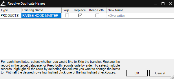

To update an existing expansion, repeat the same process for installing: download the new expansion file, extract the SDF, and import it using Database Management. When importing an update to an existing expansion, during the transfer process, another interface option will pop up to resolve the duplicate or identically named files. Simply check the "Replace" option to overwrite the files from the previous version and replace them with the new and updated files, and click OK.
