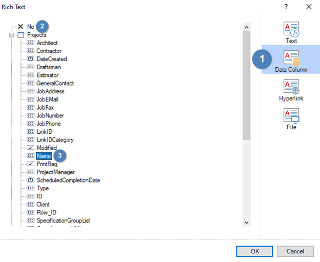

The DataColumn property can be used by the RichText component to load the RTF text from the data field. Select a field form the data dictionary tree to load the RTF text. The RTF text is automatically loaded by the report generator when the report is rendered.
Fig. 01 – Data Column Tab of the Rich Text Editor
  1. Data Column – The Data Column is the data field from which the RTF text should be loaded. The correct column is selected within the central pane of this window.
  2. Null Node – Selecting this node results in the RTF text not being loaded from a data field.
  3. The selected field is the data field from which the RTF text is loaded.
