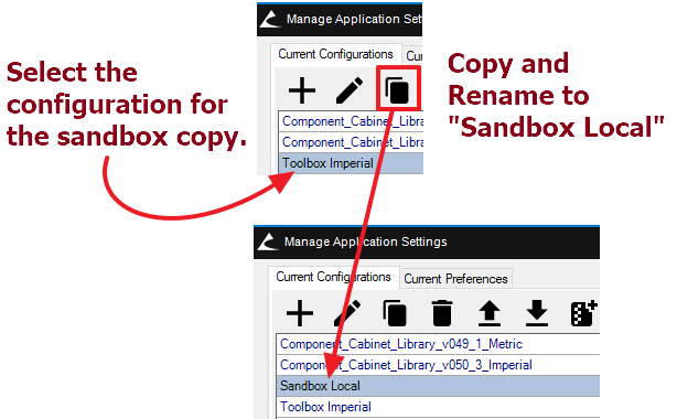

  6. Select “Manage Configurations” within the “Login Screen” (the first screen on startup).
  7. Select and Copy the desired configuration and name it “Sandbox Local."
  8. Go back to the main Login Screen and select Sandbox Local (from the drop-down) as the “Current Configuration."
