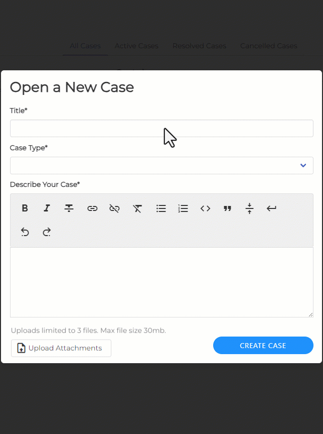

1. Begin by visiting the Microvellum Client Portal at http://portal.microvellum.com and navigate to the "My Cases" section. Here, you'll find the "Open a New Case" button conveniently located in the upper-right corner of the page.
2. In the case submission form, write a concise and descriptive case title that summarizes the primary issue or topic of your support request.
3. From the "Reason for Request" drop-down menu, select "Problem”.
With this selection, you'll notice two additional fields appearing within the case submission form:
  1. In the Product Affected drop-down menu, select the product your problem is related to. Note, that this is not a required field.
  2. Please input your current software build number (e.g., 23.1.0811.641). To locate this information, navigate to your Toolbox palette or help drop-down menu and select "About Microvellum." The build number can be found at the top left of the user interface.
  3. If your problem is related to your product library, provide your current product library build number. (i.e., 23.0609) To determine what product library build you are running, open your Toolbox application and reference the Toolbox palette. Your “Current Library” build number is displayed in the palette.
  4. If your problem is causing your production to be shut down, click the “Yes” radio option. Keep in mind, that a Production Shutdown is characterized by the inability to produce a fully tested product or operate your software across all workstations. If you can still maintain production, employ a workaround, or utilize an alternate workstation to complete the task, it is not necessary to mark "Yes" in this field.
Use the comments field to provide additional information and details about your general problem.
Conclude the process by clicking the "Create Case" button to submit your request.
