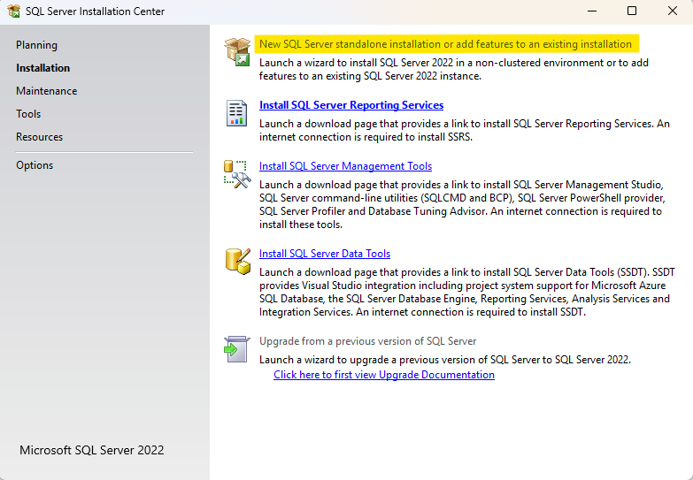

  7. Once the installation package has been downloaded and the necessary files for installation have been initialized, the “SQL Server Installation Center” box will be displayed. Click “New SQL Server stand-alone installation…”

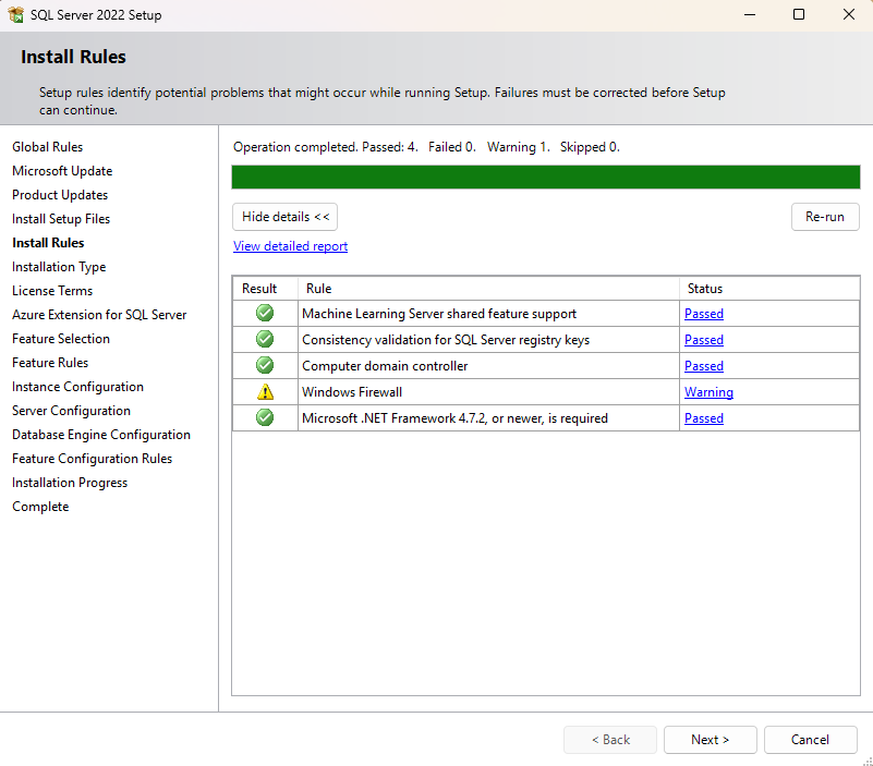

  3. The install configuration will run a check to make sure that SQL Server is ready to be installed. Here are a couple of items to confirm before proceeding.
    1. Do not run the SQL Server installation on the same computer or server that is also a domain controller.
    2. If Windows Firewall is enabled, you will need to set an exception for ports 1433-1434.

  4. Install Rules: make sure either all the rules pass successfully, or that any warnings are recognized and acted upon as necessary. The firewall may not have a status of Passed, but if you have configured the ports for the firewall as described in the articles above, click Next.

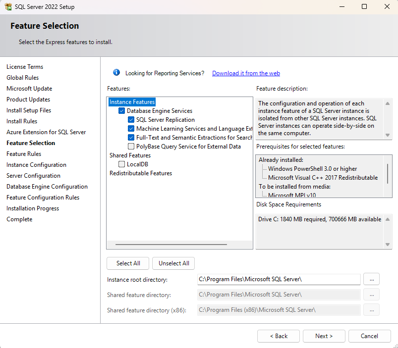

  5. Feature Selection: accept the default settings and click Next.

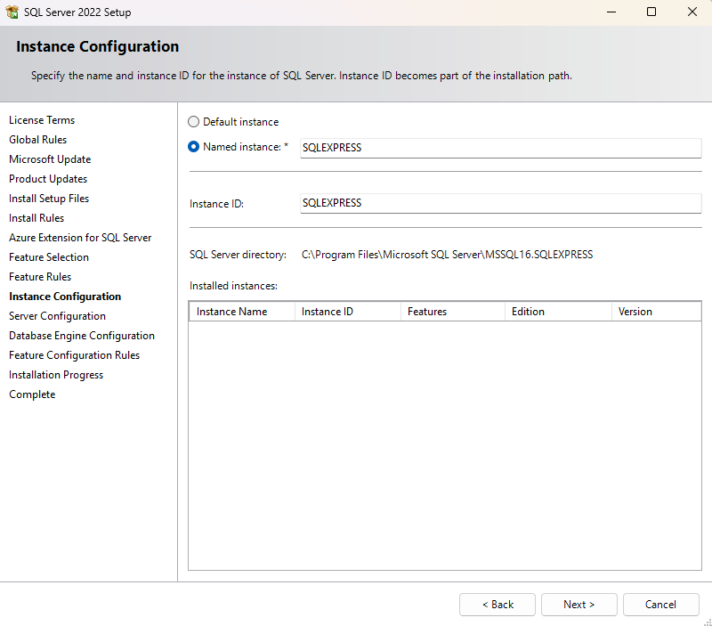

  6. Instance Configuration: name the instance of SQL Server that you are installing. If you don’t have a preference, otherwise, leave it as is and click Next.

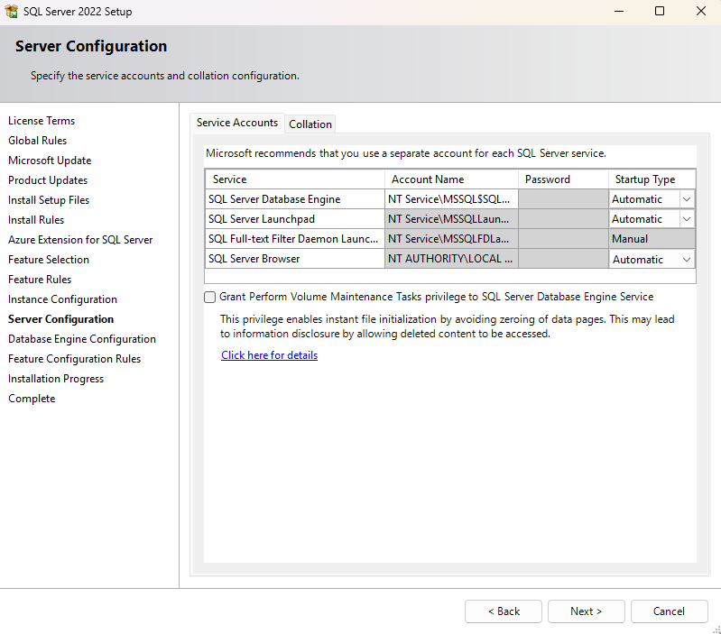

  7. Server Configuration: set the SQL Server Browser Startup Type property to “Automatic” if not already set to that value.

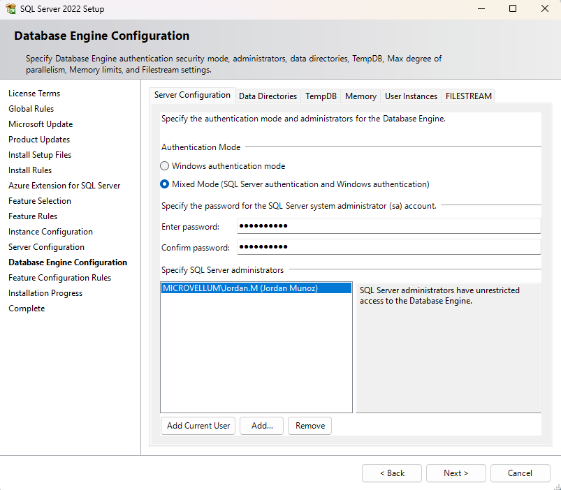

  8. Database Engine Configuration: set the Authentication Mode to “Mixed Mode” and specify the System Administrator account (sa). Enter and make a note of the password in a secure location.
