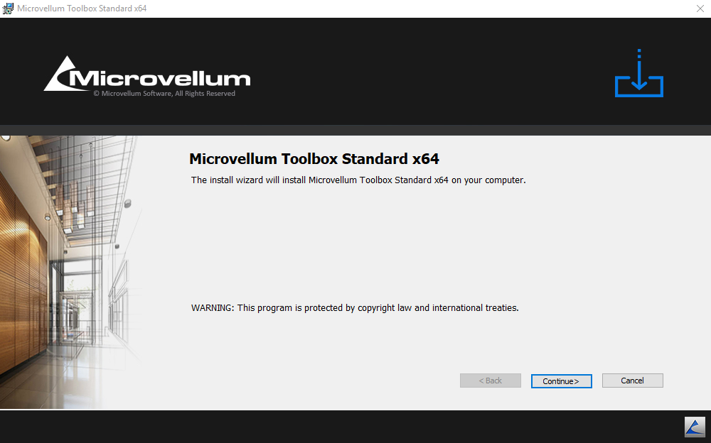

Below is a systematic guide for installing Toolbox AC. Before installation, we recommend reviewing our  Pre-Installation Instructions  and  System Requirements .
  1. Right-click on the Setup.exe file and select “Run as administrator”.
  2. Observe the initial installation window (as seen above) and select “Continue”.
  3. Read and accept the license agreement and select “Continue”.
  4. Observe the release notes screen and select “Continue”.
  5. Configure the desired destination folder and select “Continue”.
  6. Configure the Toolbox installation to match the desired version of AutoCAD. For Toolbox Standard 2025 select “AutoCAD_English_2025_X64” and select “Continue”.
  7. Observe a notification upon successful installation.
  8. Toolbox Standard will be available via the AutoCAD version specified in step 6.
