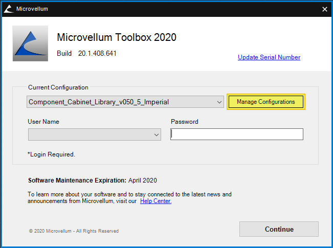

1. To start, open your Toolbox application and wait for the Splash Screen. Select the Manage Configurations button next to your current configuration.

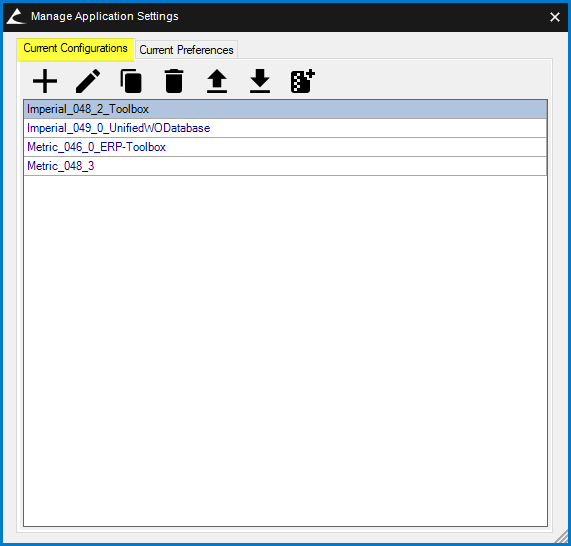

2. A Manage Application Settings dialog box will appear. Select your desired configuration and select the "Export" button.

The screen "Manage Application Settings" contains two tabs and associated data.
  • The tab Current Configurations includes those configurations that are currently attached to your current software session. It commonly contains information directly related to each set of libraries you have setup. You may add to this list of configurations, rename any of them, make a copy, delete one, or exported one to another system.
  • The tab Current Preferences commonly contains information directly related to the various properties found on the Options screen.

  1. "Add" a configuration.
  2.
    Click from the list of all configurations of all Microvellum software products on the computer, to add to the current software product that is open.
    Fig. 3
  1. "Rename" a configuration.
  2. Enter a new name for the configuration highlighted.
    Fig. 4
  1. "Copy" a configuration.
  2. Make a copy of the configuration highlighted.
  1. "Delete" a configuration.
  2. Delete the configuration highlighted.
  1. "Export" a configuration.
  2. Assemble all the configuration components and create a file with the extension MVG for use when importing this configuration to another computer, software product, etc. Navigate to a location on the disc to save the configuration file. Use this command on a source computer to set up a new user with a configuration that exactly matches the computers of your other users.
  1. "Import" a configuration.
  2. Migrates or brings the configuration components from another computer or software product into this product. Navigate to a location on the disc where the configuration file to import is located. Use this command on a target computer to set up a new user with a configuration that exactly matches the computers of your other users.
  1. "New from default libraries…"
  2. Creates a new configuration from the default library you select. These default libraries are installed when the program is installed before you install a specific library type or version. After initialization is complete, the configuration will show up in the list named according to the unit type you select in the process. For example, if you select Metric, the name of the new configuration will be Toolbox Metric.
Current Preferences Tab
Fig. 5
  1.  "Add" a Preference
  2. Click from the list of all preference, of all Microvellum software products on the computer, to add to the current software product that is open.
  1. "Rename" a Preference
  2. Enter a new name for the preference highlighted.
  1. "Copy" a Preference
  2. Make a copy of the preference highlighted.
  1. "Delete" a Preference
  2. Delete the preference highlighted.
  1. "Import" a Preference
  2. Migrates or brings the preference properties from another computer or software product into this product. Navigate to a location on the disc where the preference file to import is located (MVF file extension). Use this command on a target computer to set up a new user with preferences that exactly match the computers of your other users.
  1. "Export" a Preference
  2. Assemble all the preference properties and create a file with the extension MVF for use when importing this preference to another computer, software product, etc. Navigate to a location on the disc to save the preference file. Use this command on a source computer to set up a new user with preferences that exactly match the computers of your other users.
