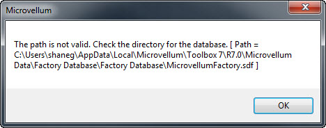

If you receive the error, The path is not valid. Check the directory for the database, go through the following steps.
This indicates that the path to your Microvellum data is not correct, and the program cannot access or find the Microvellum Factory.sdf file. To fix this do the following:
