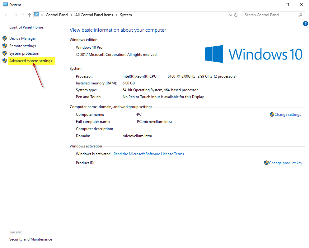

  1. Press the Windows key and enter "advanced system settings" in the search bar.
  2. Alternatively, open the Control Panel app and click the "System" icon. In the System screen that is displayed, click the link for "Advanced system settings."

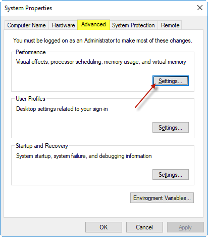

  3. In the System Properties screen, click the Advanced tab and then the Settings button.

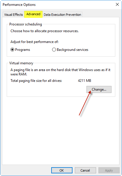

  4. In the Performance Options screen, click the Advanced tab, and then the Change button in the Virtual Memory section.

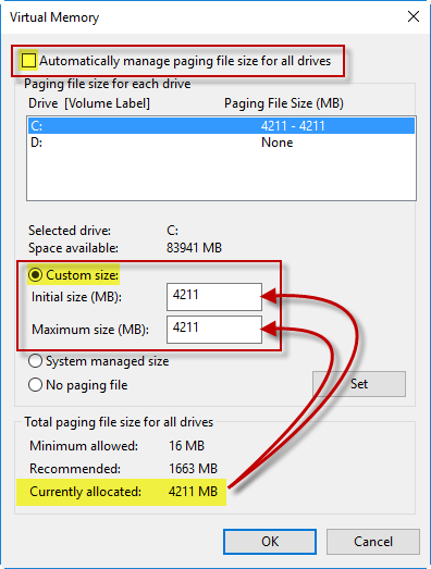

  5. In the Virtual Memory screen, uncheck the checkbox "Automatically manage paging file size for all drives."

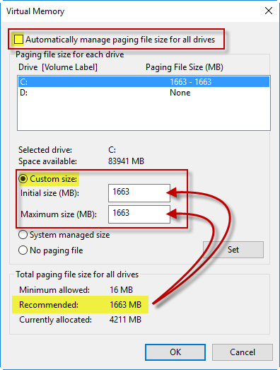

  6. Select the C: drive and click the option button for "Custom size:"
    Enter the value Windows displays for the Recommended file size in the two boxes, "Initial size," and "Maximum size."
    If the "Currently allocated" value is greater than the "Minimum allowed" value and your remaining hard drive space (Space available) allows it, it is recommended practice that you enter the value for "Currently allocated" in the two boxes, "Initial size," and "Maximum size."
