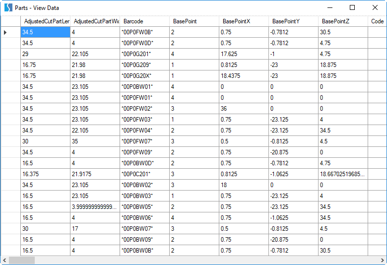

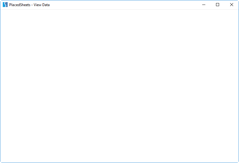

  4. Right-click on each table to confirm that the resulting grid contains data. If the resulting data grid looks like Figure 1, it is OK. If it is blank and looks like Figure 2, the dataset definition needs to be repaired.
  5. Fig. 1
    Fig. 2
  6. If the data grid is blank like Figure 2, proceed with the “Resolution Tutorial” below. Otherwise, look elsewhere for a solution to the missing data.

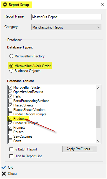

  2. Click the button: “Edit Data Source” and click the database type for the offending table found in the pre-test above.
  3. Fig. 3
  4. Uncheck the checkbox for the offending table, and click OK.
  5. Open the again in the Report Viewer, so you see the rendered report.
  6. Click the button: “Edit Data Source” again and click the database type for the same offending table.
  7. Check the checkbox ON for the table, and click OK.
