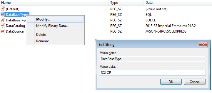

  • Right-click on "DataBaseType" and "Modify" – change "SQL" to "SQLCE" – restart the program.
  • Startup Toolbox, go to Toolbox Setup > Options > Data Access > Set to SQL Server and reconnect to your SQL server by DataCatalog and DataSource -- Be sure to test the connection!
